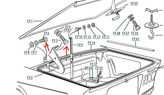

Just a long shot, But as Kevin suggested maybe after you remove the cardboard from the the passenger compartment maybe with a few extentions and a socket you could reach in over the gas tank and remove the trunk lid bolts (FF6 or FF3) in the illustration?
My father had a simialr problem with his '52 Studebaker. He had to remove the rear seat and reach in through an access hole the size of a silver dollar with about 3-4 extentions to undo the trunk lid bolts. Took him a long time and a lot of swearing but finally got the bolts out.
I'm thinking <span style="font-style: italic">straight </span>back, to undo the 2 nuts holding the lock; don't have my 6 here with me, to take a further look....
