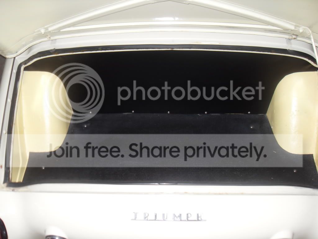

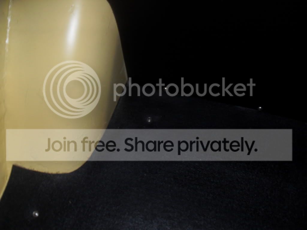

I';m sorry that I'm just now posting I used the 5/64 drill bit to pre-drill all of the interior screws that I used.. Also I ended up using #6 screws for the tunk mat because the holes were slightly larger.
Earl, How many screws did you use on the hardura boot floor covering? TRF sent four with the mat but I think more would make sense.
Thanks, Dick
Sorry that I'm just now posting a pic too many long hours right now. Here's a shot of it. The mat was considerably thicker and more flexible than the original. I made the boot closeout my self, but the mat is VB
Thanks for the pics Earl, I can use them also. Nice job on the close out panel!
