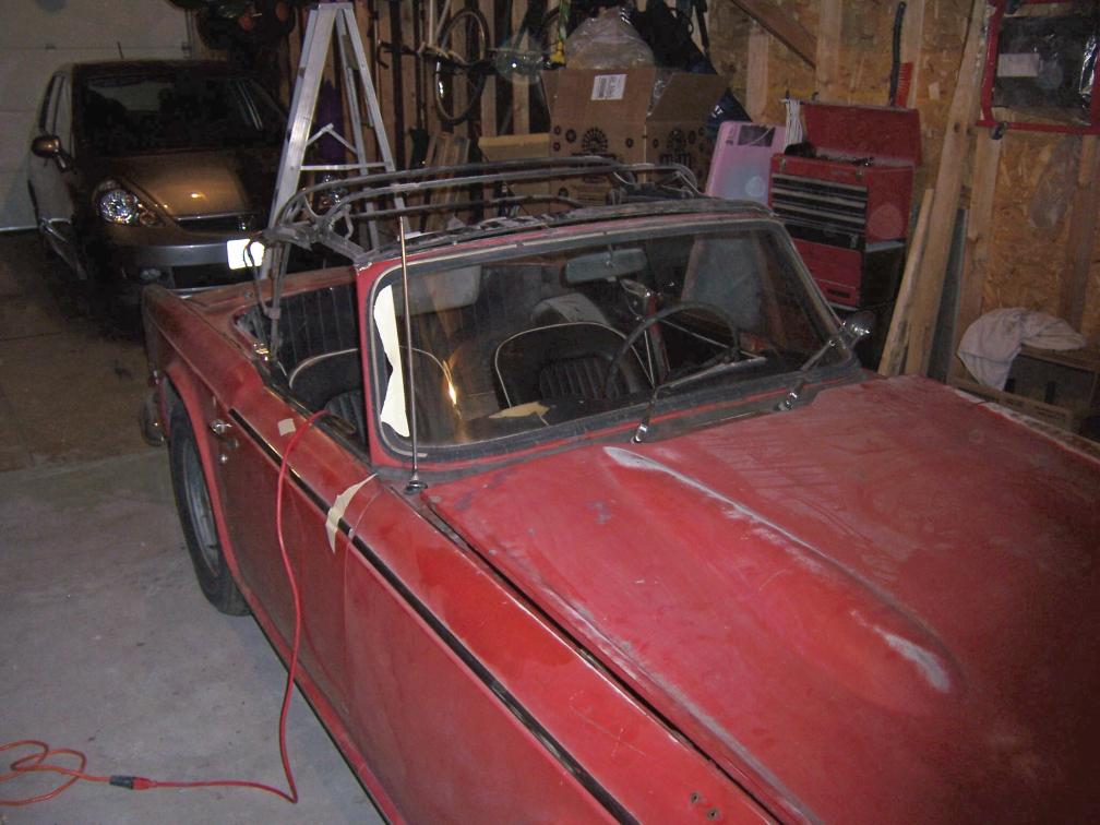

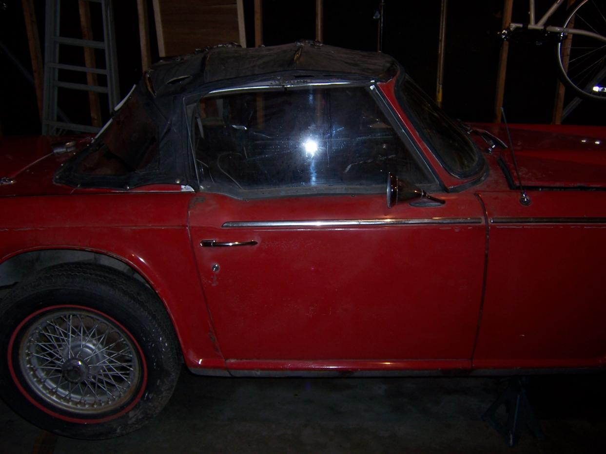

Dang, maybe I was wrong, from my own picture archives, a very original TR250 I owned for a brief time about 6 years ago, although it looked like it had been resprayed 000_0381.jpg once. And then there is a pic of my current car when i got it once again the side piece sloping down. Looks like a may need to eat crow.

Greg- That post I did on the first TR5 has its beading like this
