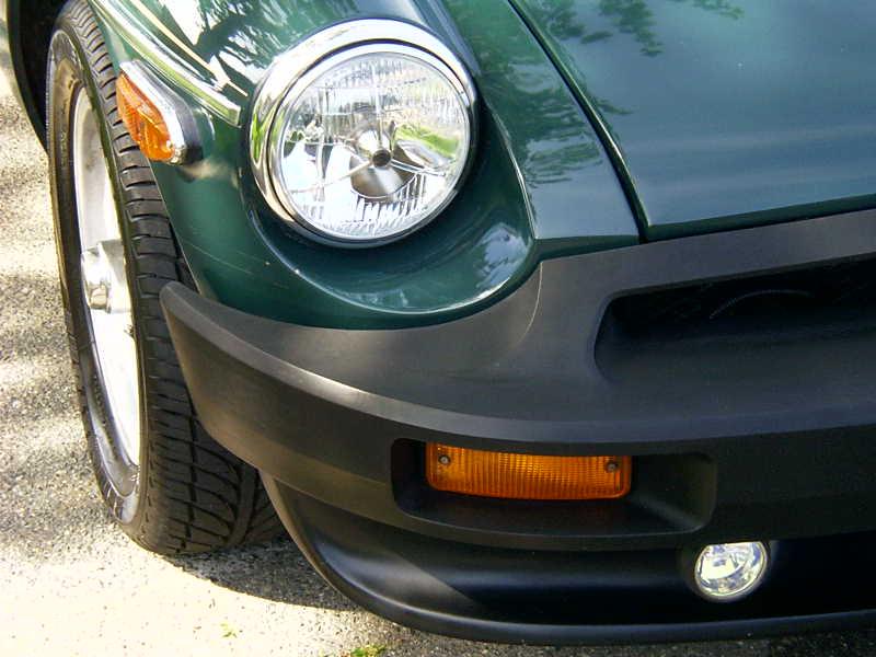

I just installed Moss's tripods on my 78B and loved'em. But you are correct - they don't come with halogen bulbs and are quite dim compared to the sealed beam halogens they replaced. Thats why I spent the extra ($$) for the halogen bulbs made for the Tripod.
Moss PN #170-695 & cost about $20 each.
In stalled the Halogen bulbs & now I really love the tripods. /ubbthreads/images/graemlins/thumbsup.gif

Yup! They work with the P700s & just popped right in without any problem.
Good luck,
Bret
Boy they look nice. In fact just lovely.
