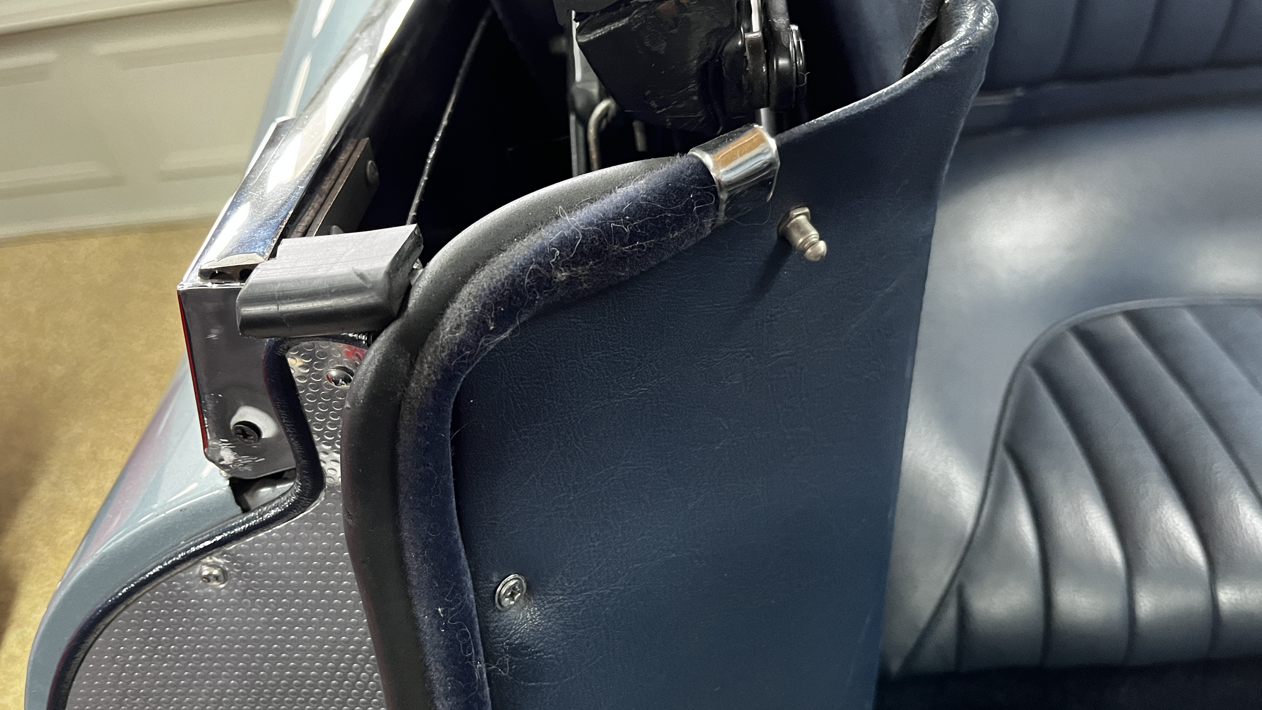

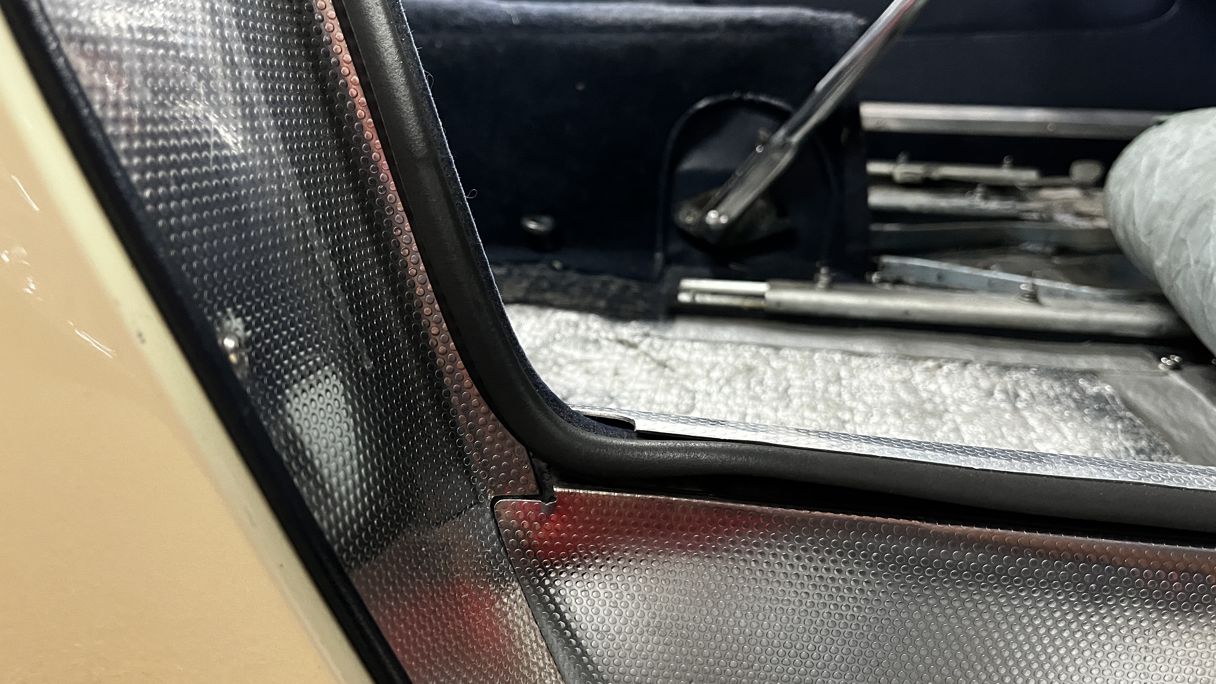

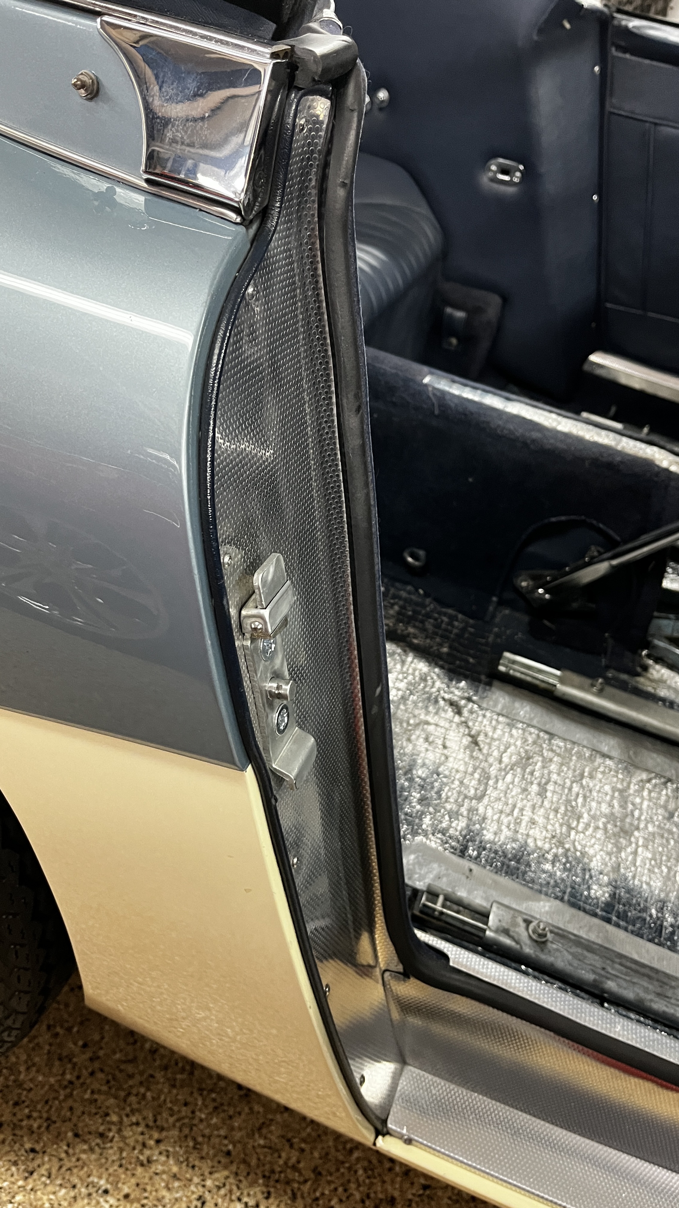

Does anyone with a Healey ever stop fiddling? I was hoping to get some advice from members here about the aesthetics of the exposed hardware and body located right at the frontmost portion of the snap-on cover. Photos are attached for reference.
There are fabric tears and sun damage to potions of the upholstery so I think I should bite the bullet and order in some seat kits and cushions and have somebody skilled install them.
The snap-on convertible cap on this BJ8 seems to fall about 2 inches short of covering the parts exposed here, including the top of the fur flex and the horizontal angled body in this region (Note the black tape topping it). Could someone suggest a way to finish this correctly? Is something missing? Should I order a new cap with the correct front-to-back dimensions?
Thanks for your consideration,
Dave

You're missing Moss part number 803-875, 803-885 SEAL, shut pillar, top L/H, R/H (photo attached)

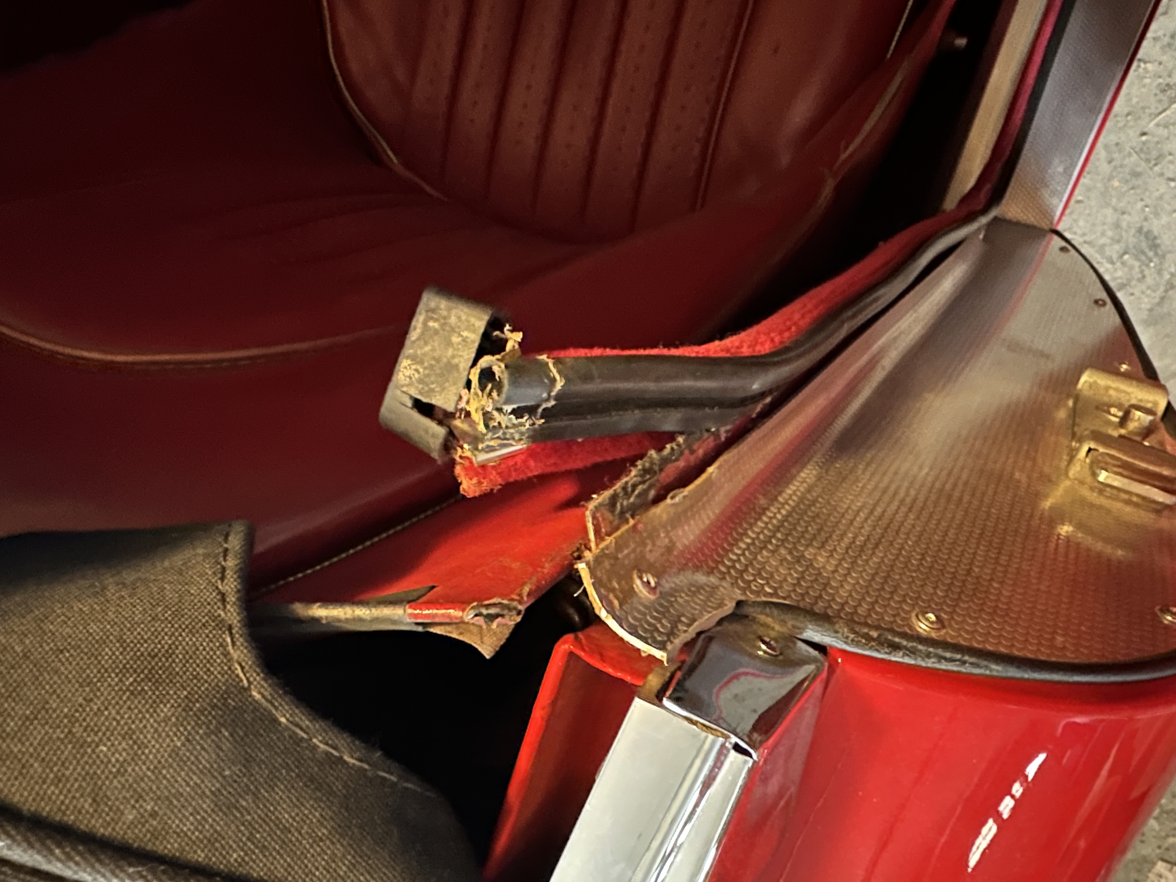

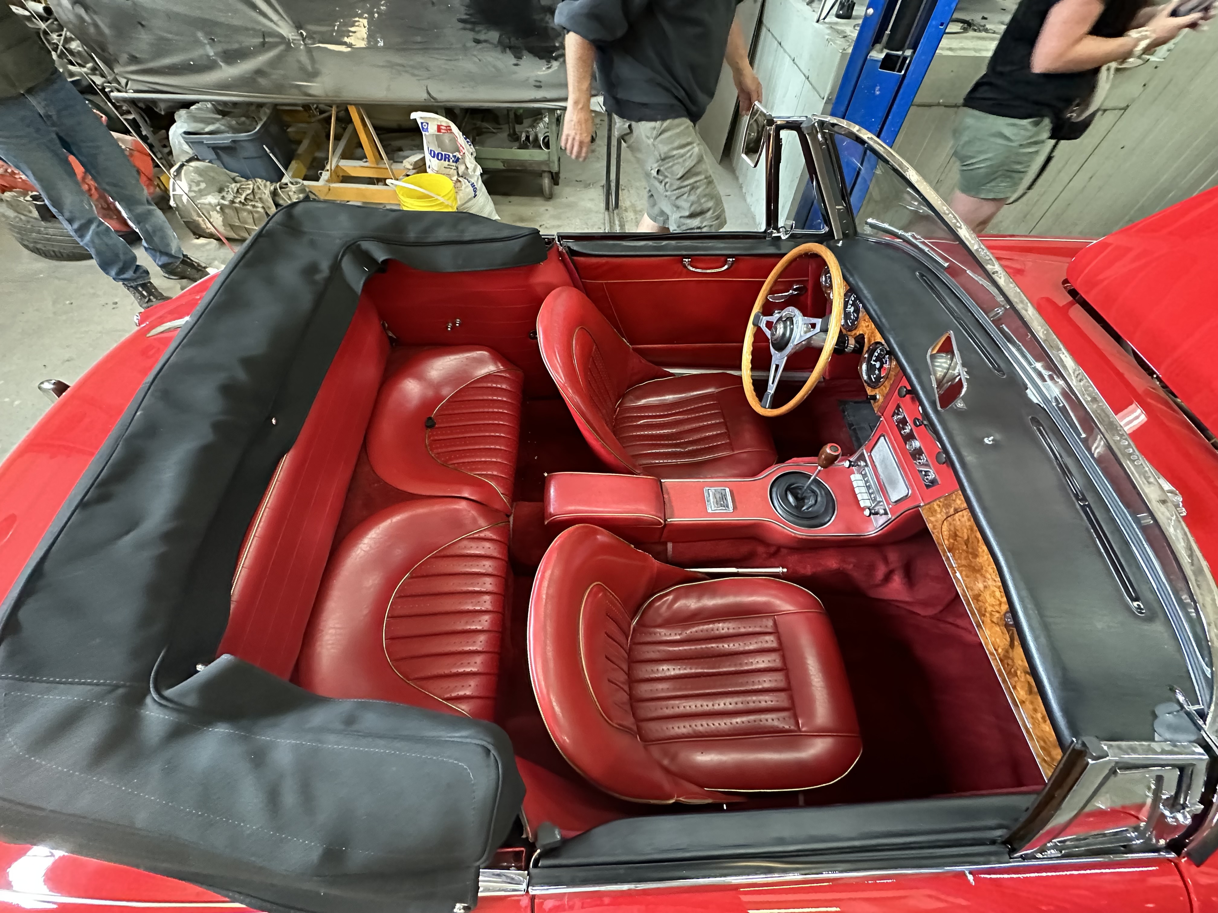

Here's a photo showing how the fur flex should extend, with the finishing clip.

Dynamite! Thank you for the very kind and informative response!
Looks like I need to find more red Furflex, hopefully not needing the full length. However, splicing may not be a good idea.

Mmm, similar to the BJ7 then, my furflex will curl over onto the internal rear quarter panel in the same way, about 150mm ish in from the door.
