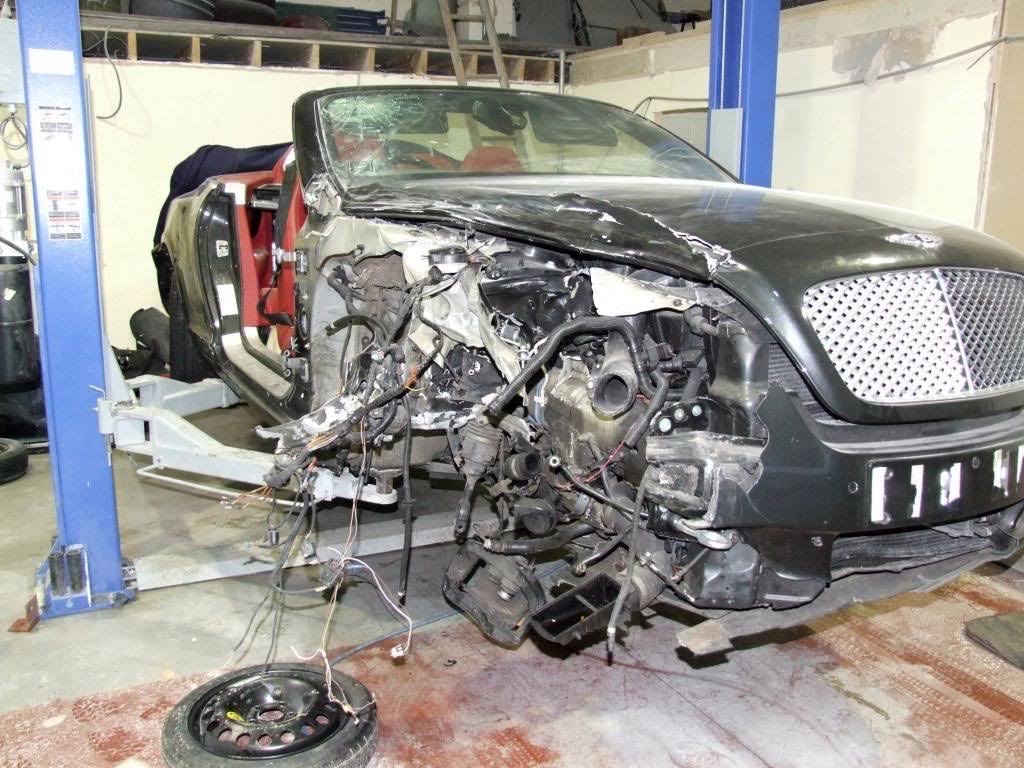

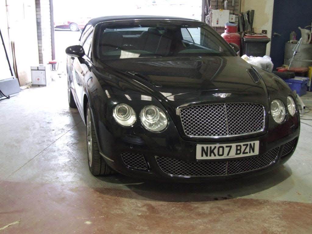

no mechanical boot release on the car inside or out, no sparks, no work. the one i repaired the fire brigade cut a hole in the boot lid to get access to the mechanism, it was only after i repaired the boot lid and the battery went flat i called the dealership and they told me how to get in through the light
Before and after
Yikes - 100% dependent on the electrical system. As we used to say ... what a way to run a railroad.
Great job on the repairs!
