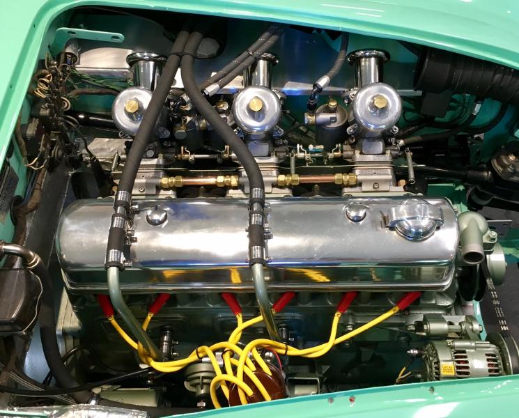

For sure Richard, stay with three. Once they're set, there's no issues with triple SU's. Plus they look pretty sweet.
'57 Healey Motor 5:17 2.jpg
