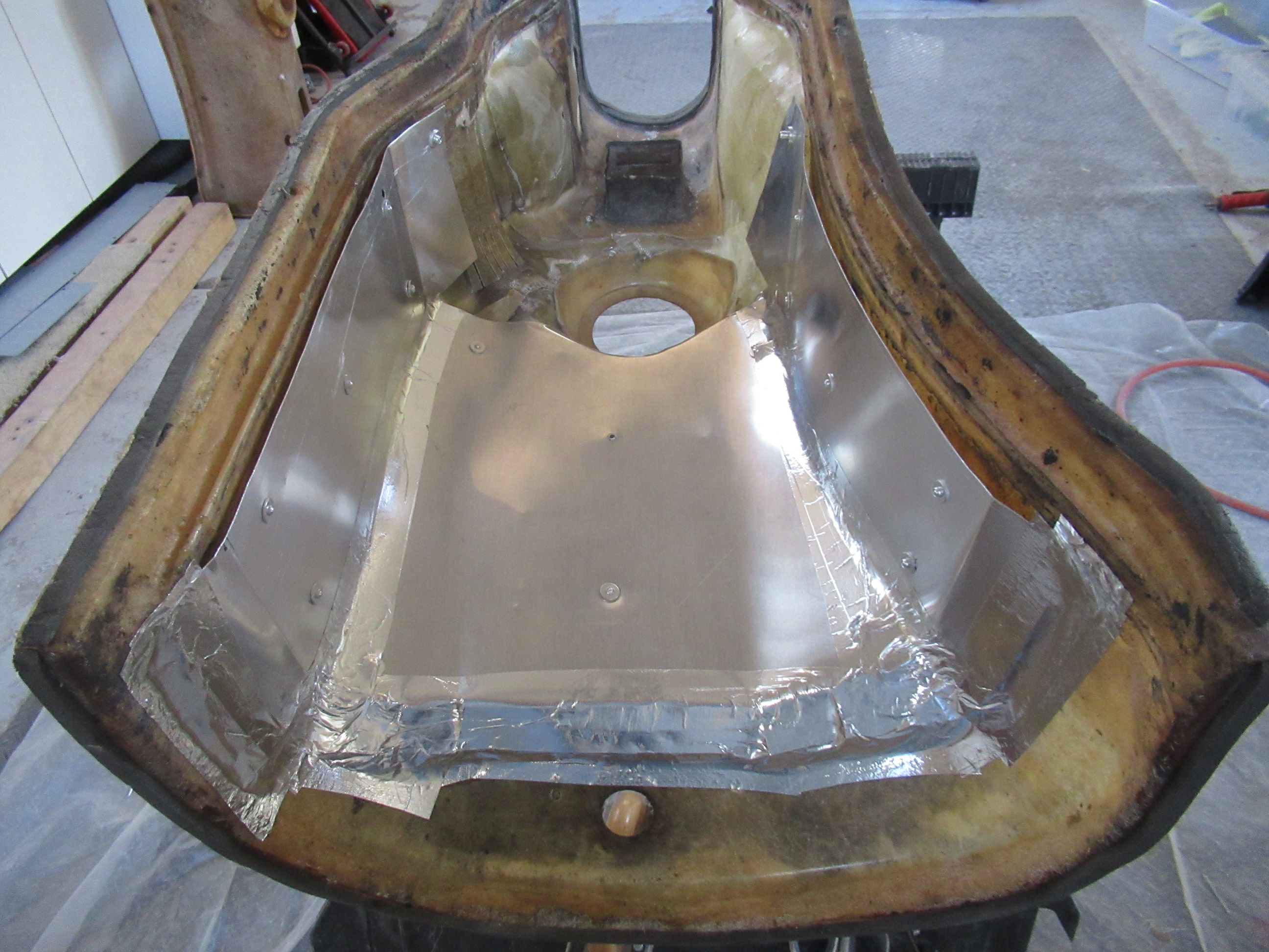

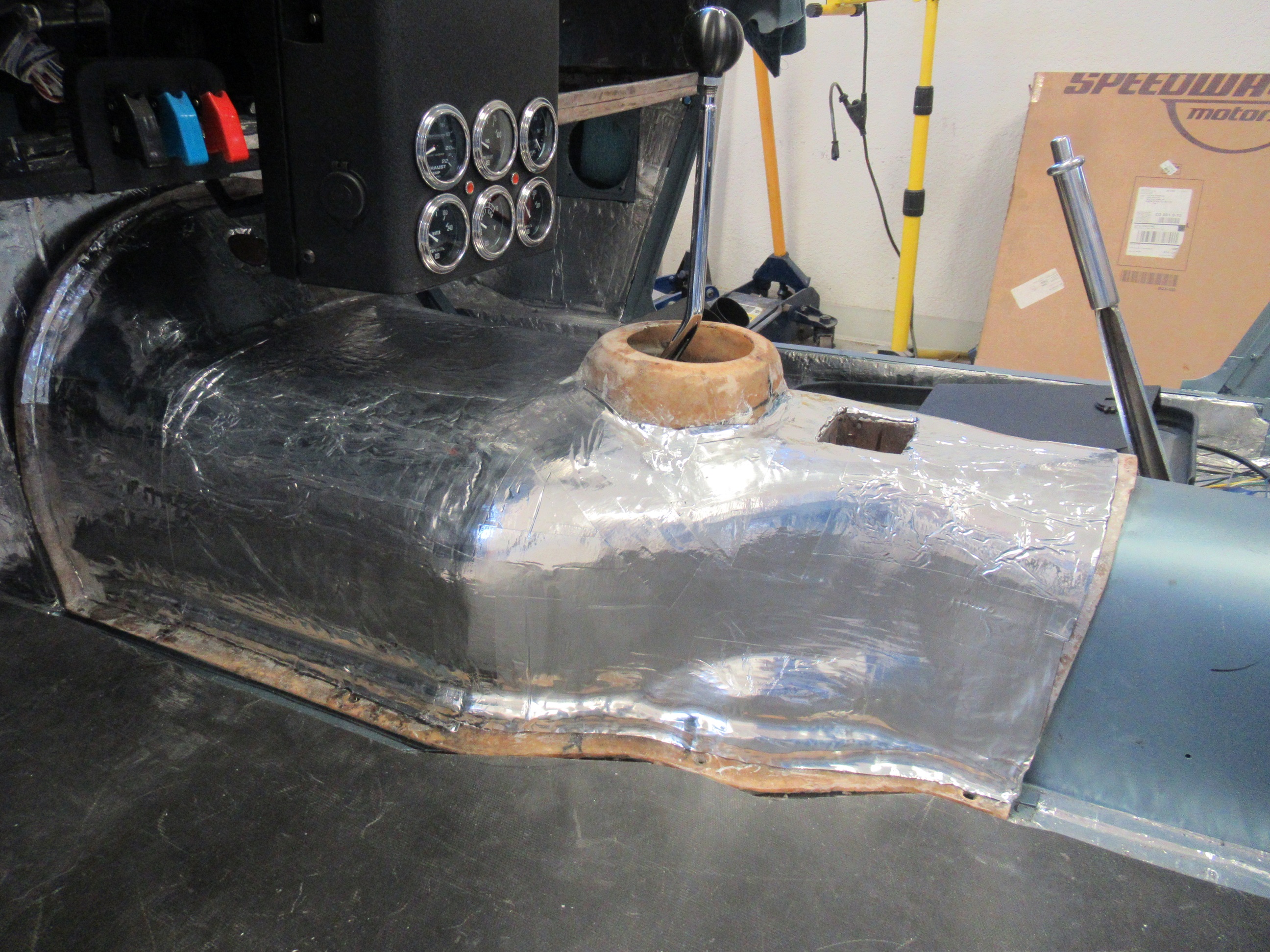

FWIW ... OK... late to the party... and maybe nobody cares at this point.... but I'm kinda in Red57 camp regarding engine/transmission heat buildup.... at least that's how I read his comments. That was my concern ... and it is why I choose to allow the heat/air to continue to move out of the engine compartment and over the transmission. I used aluminum panels spaced 1/4" off the tunnel to direct air and isolated the transmission tunnel. I then added insulation on the outside of the tunnel (HushMat Ultra) to further isolate the heat from the interior. I did this on my last build and current build and have been satisfied with the results.

But, as I said, I'm very happy with the results... tunnel stays cool and, seemingly, I don't add to the buildup of heat in the engine/transmission.

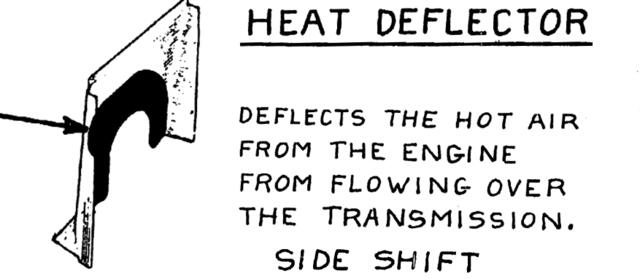

Interesting that the early cars had the heat shield and it didn't seem to have any negative effect in the engine/transmission bay. Why wasn't it continued in the BJ7 BJ8?

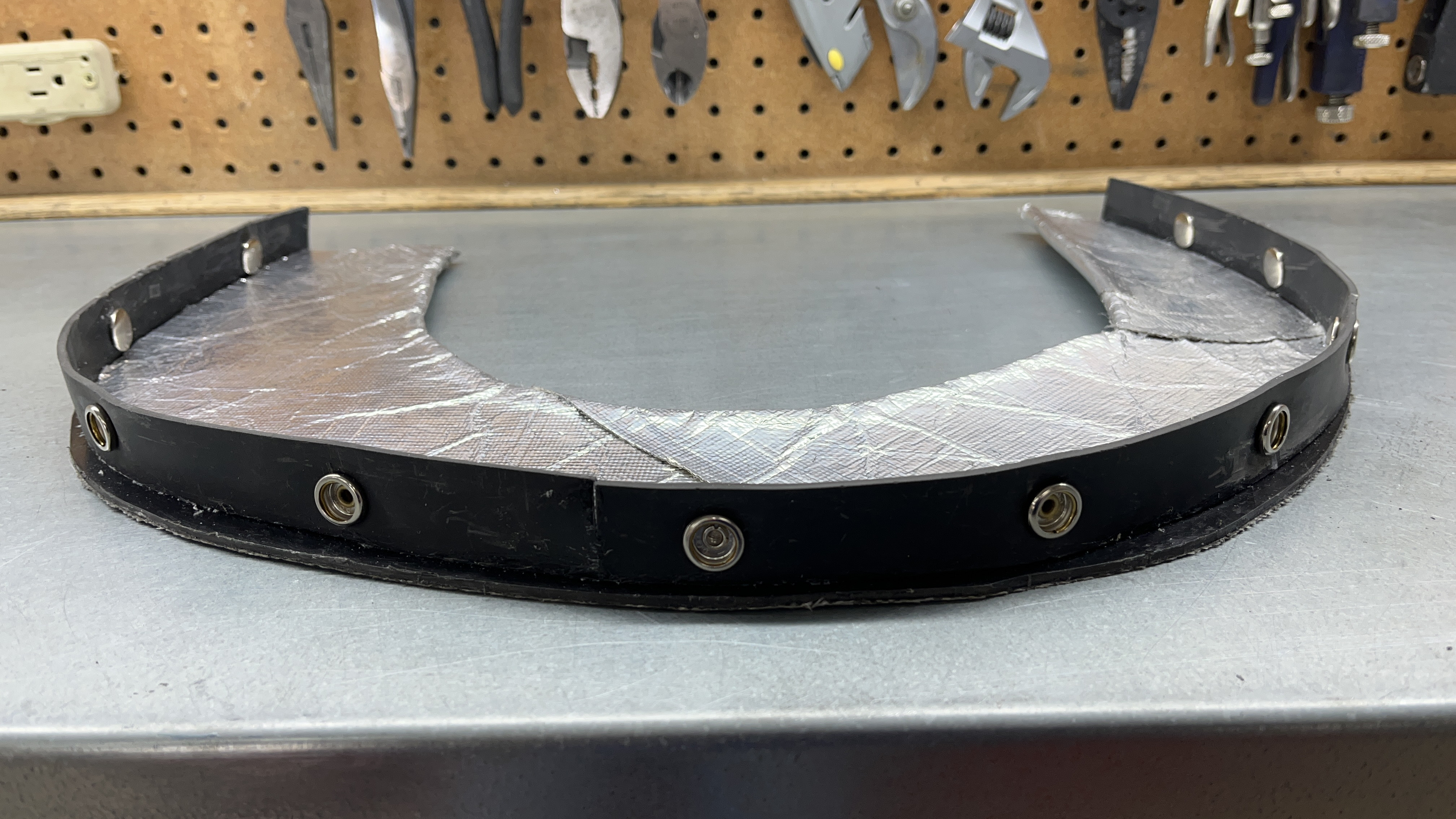

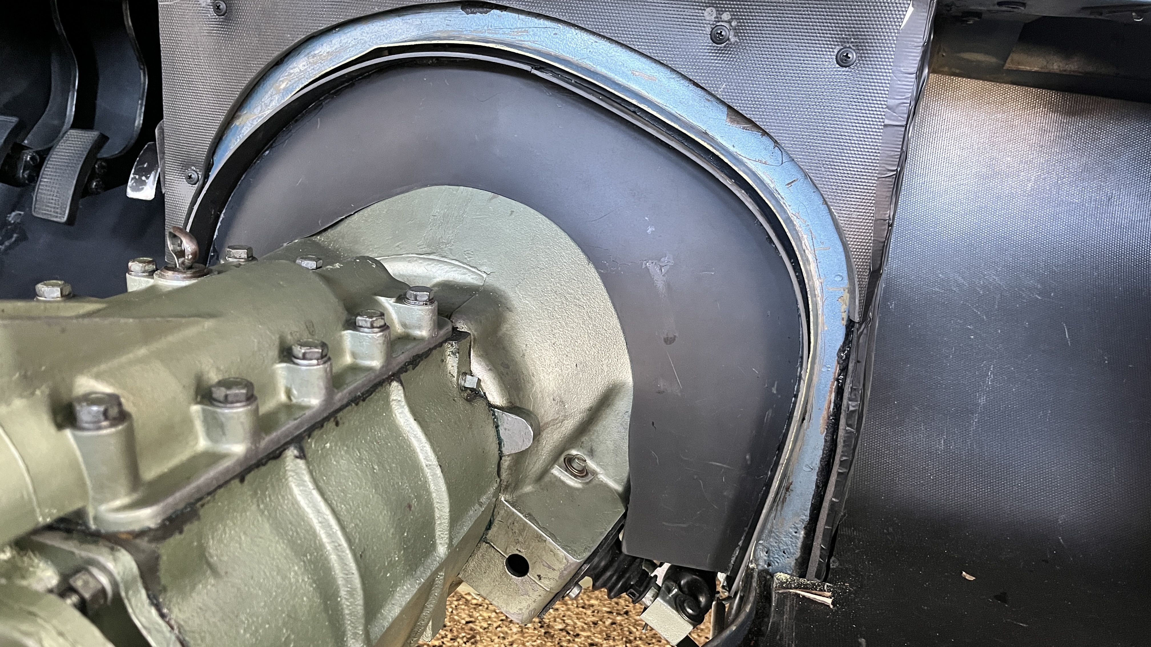

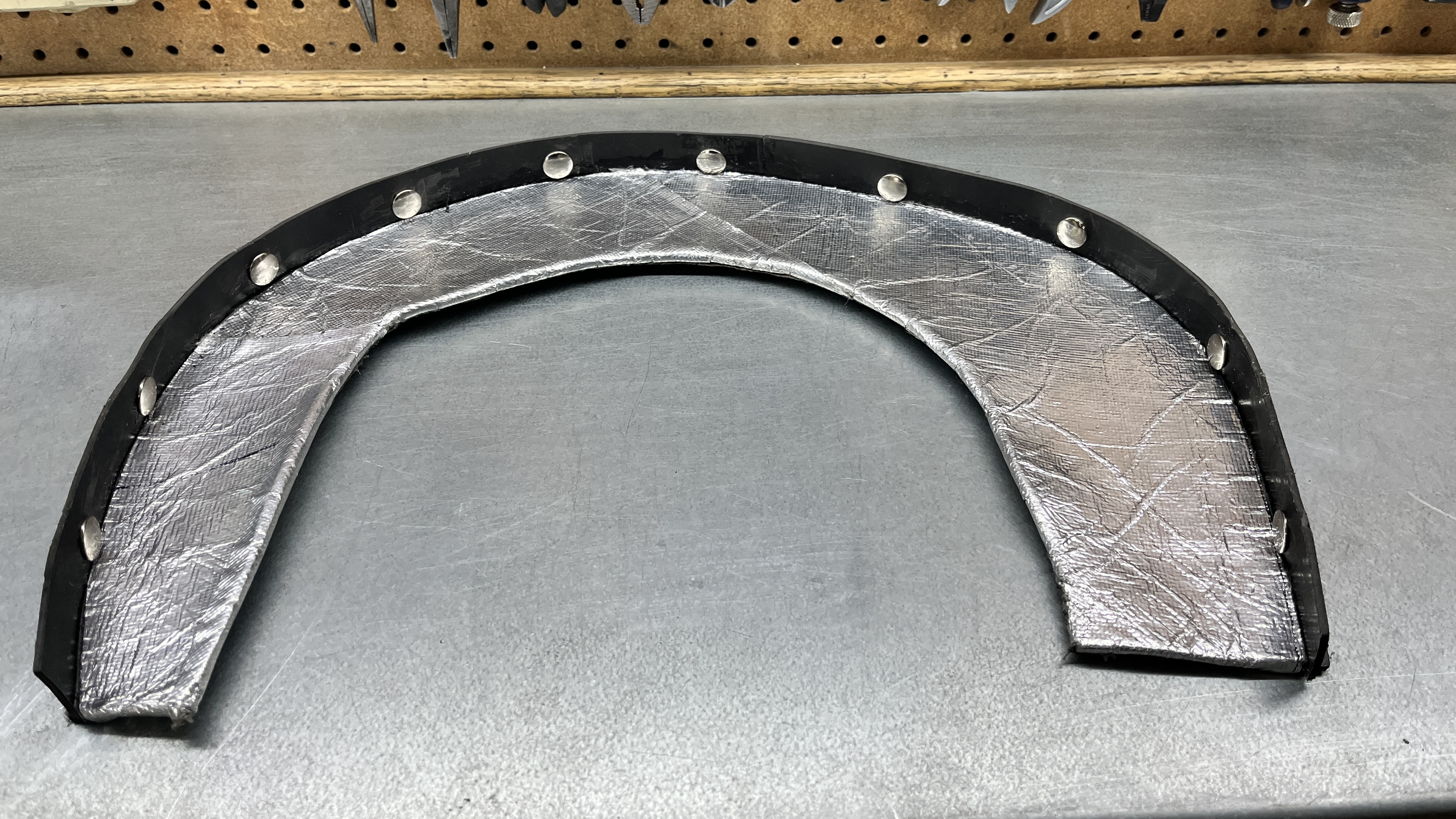

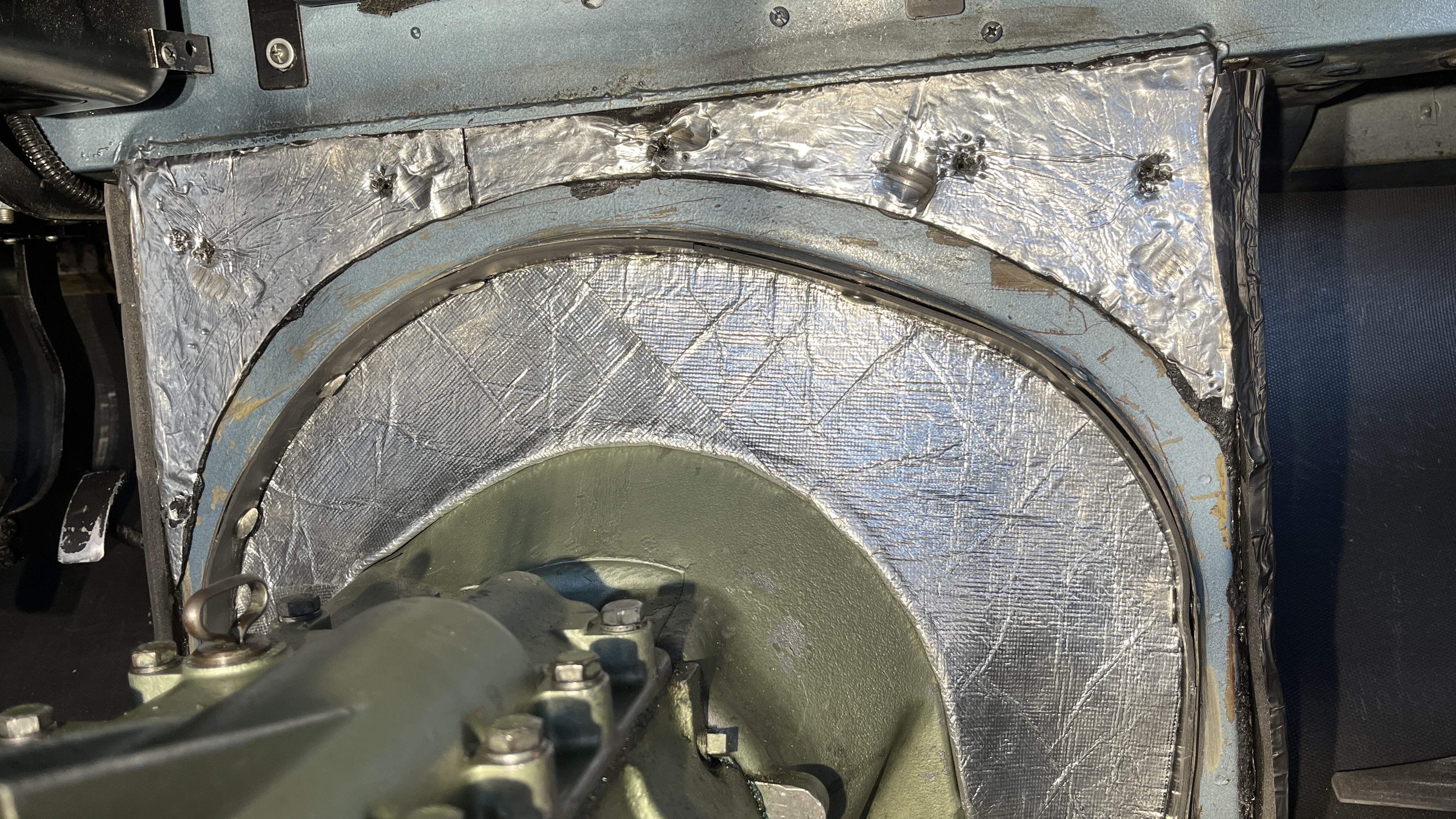

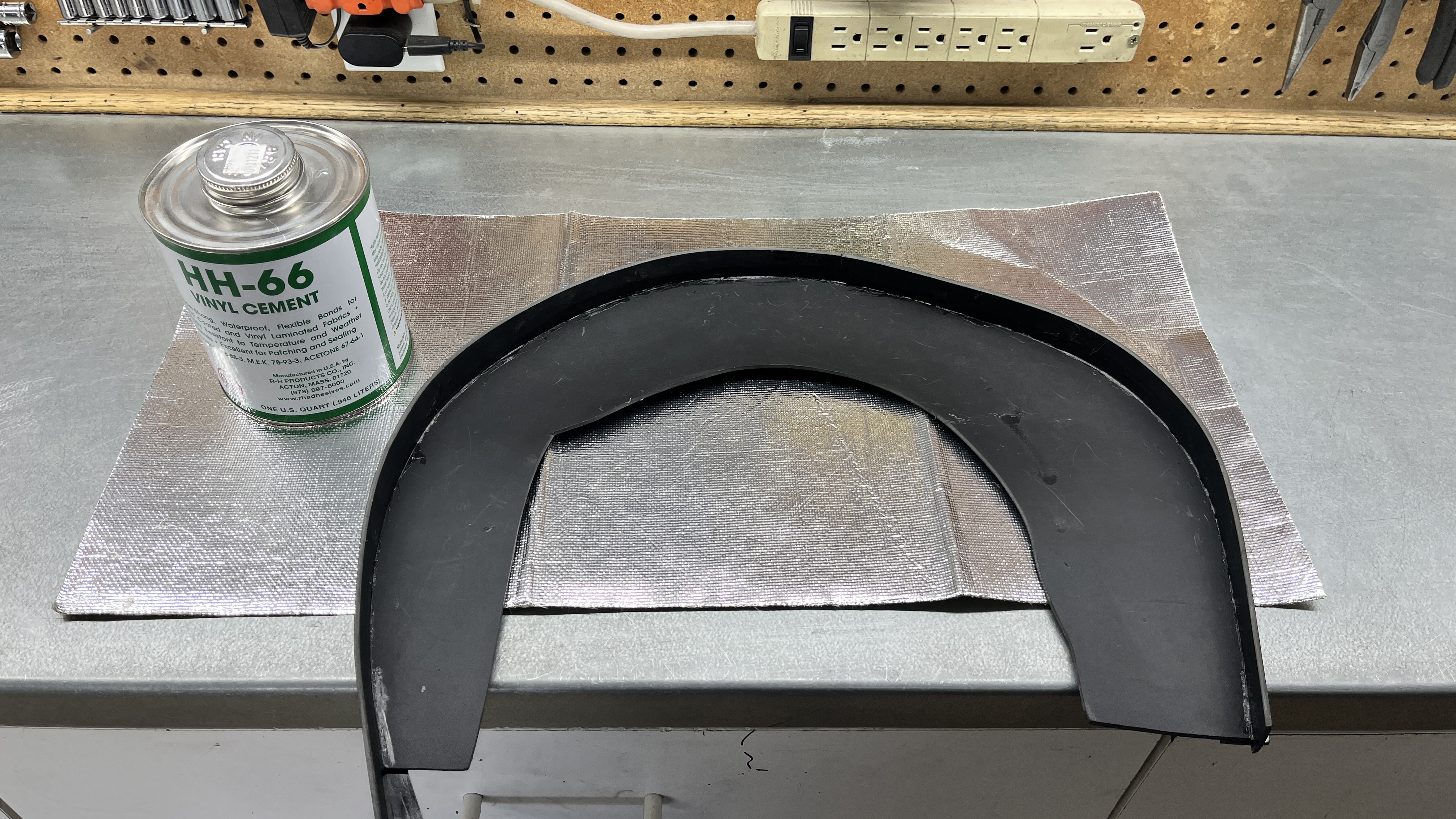

1. To address that I wrapped the top of the down pipes to the mufflers with DEI titanium rap. That made a significant reduction in heat and hot air.

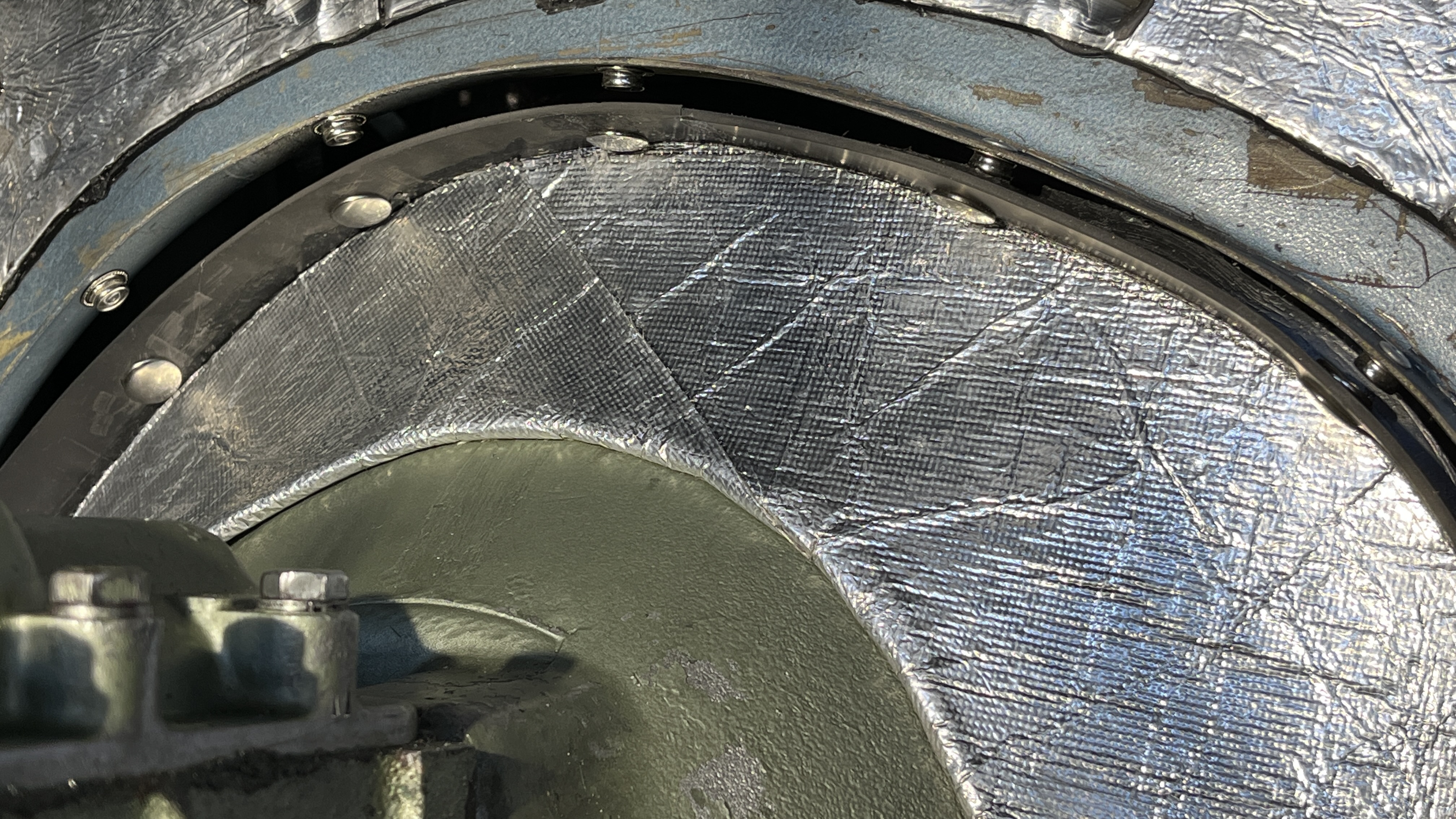

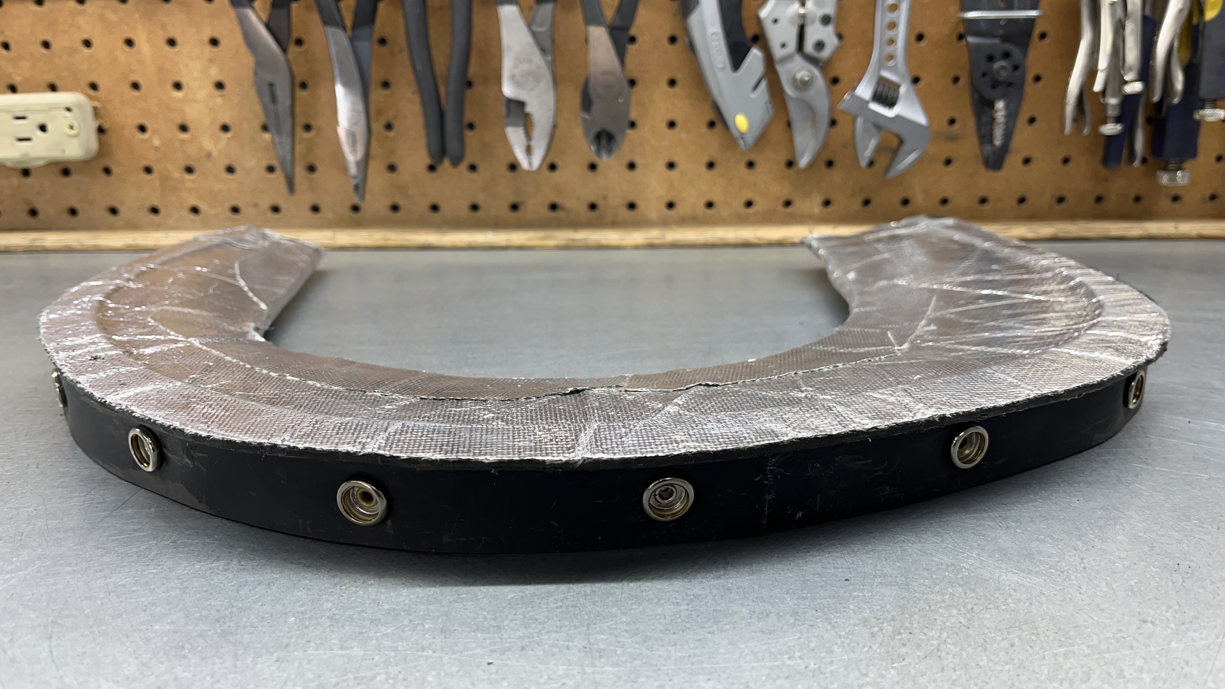

2. I made a transmission heat deflector like the earlier Healey to address that entrance point.
As they say, it looks good on paper. I will drive with it installed and monitor if it makes an improvement or caused any heat issues in the engine bay.
With all my modifications, they are not permanent and reversible.
The heat shield was dropped with the introduction of the center shift gearbox which took place during tri-carb production (BT7&BN7).

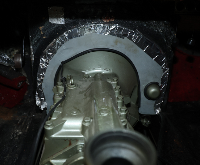

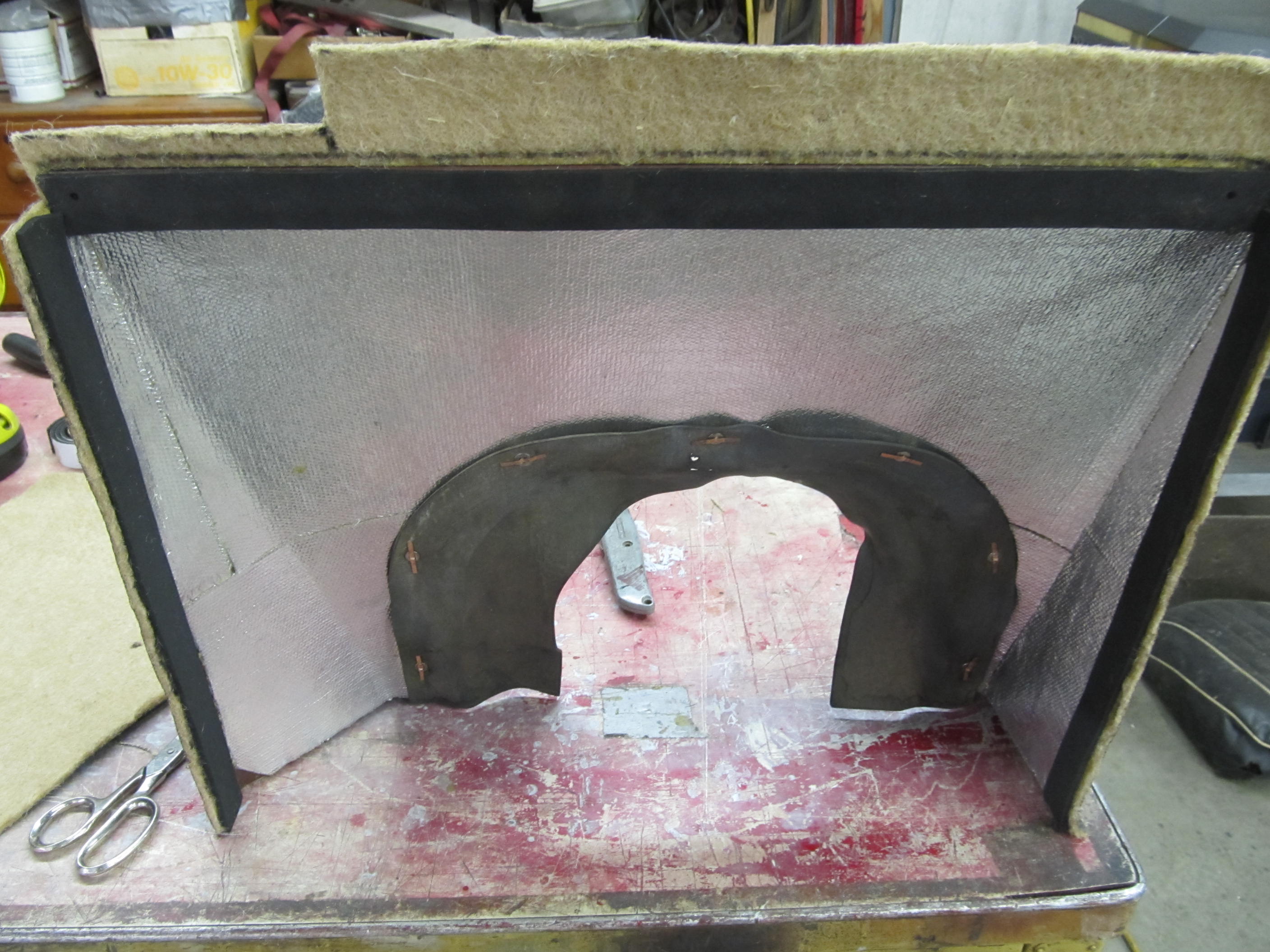

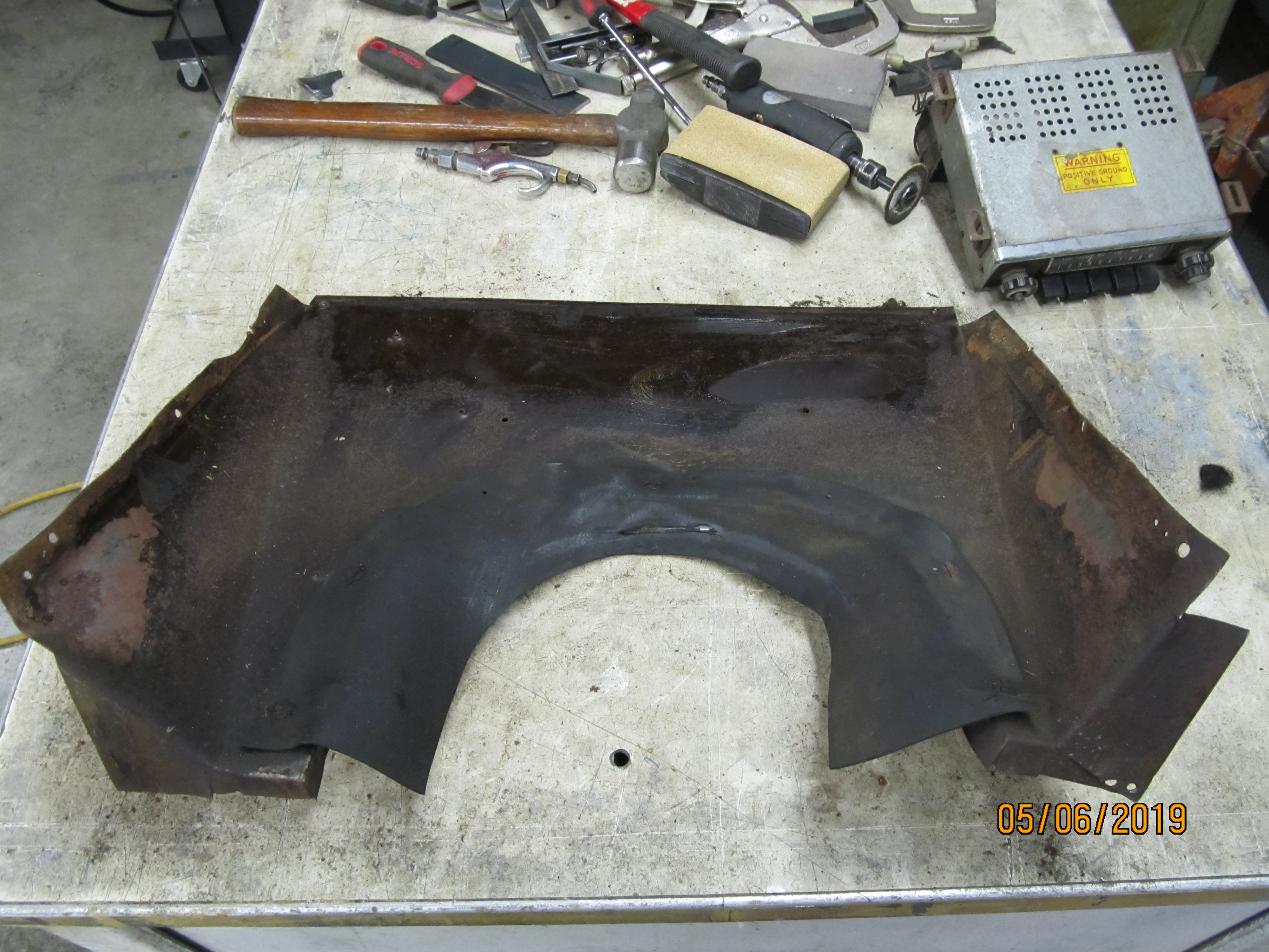

Here are some poor photos of the heat shield fitted to our BT7-tricarb.

One fellow that fitted one to his tri-carb had temperature issues. Haven't asked anyone else. I've had overheating issues, but don't know if I can tie it to the heat shield or not.
It does reduce the heat in the passenger compartment.

Since this discussion has kinda morphed from a simple heat deflector question to a cockpit heat discussion... I thought I'd offer more food for thought. As mentioned earlier, I'm of the opinion that you want to get heat out of the engine compartment, and keep the tunnel open for heat excavation. So I took a rather holistic approach to keep heat at bay, i.e. everything I could. I added aluminum panels over the original heat shields (which are now the replacement for the original asbestos), then the header/exhaust pipes were ceramic coated inside and out to reduce their temperature (the muffler is only ceramic coated on the outside). I already talked about the tunnel panels. The interior is Hushmat throughout with an extra layer of Extreme Plush on driver side and firewall. All in all, seems to make for a pleasant interior.

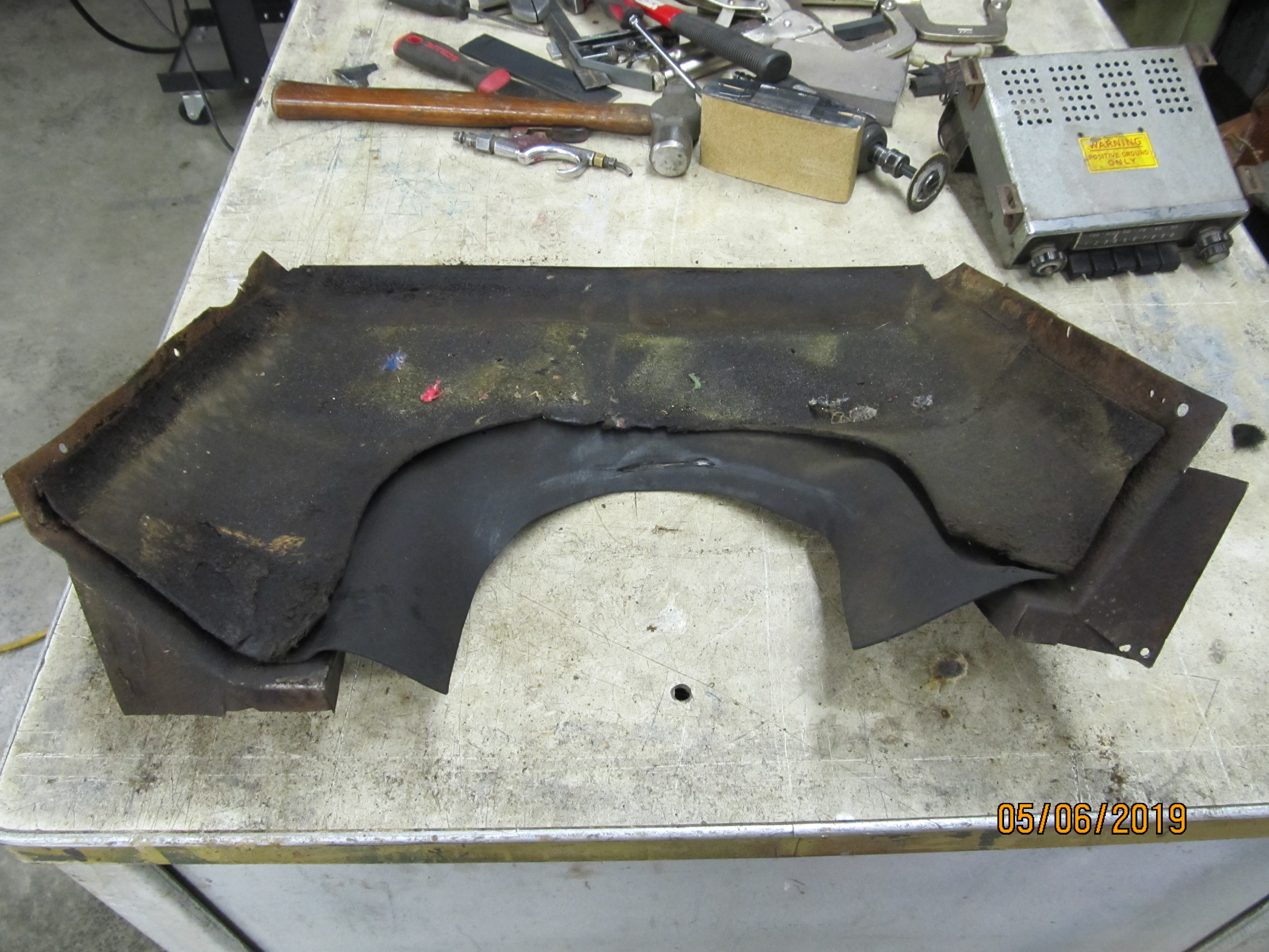

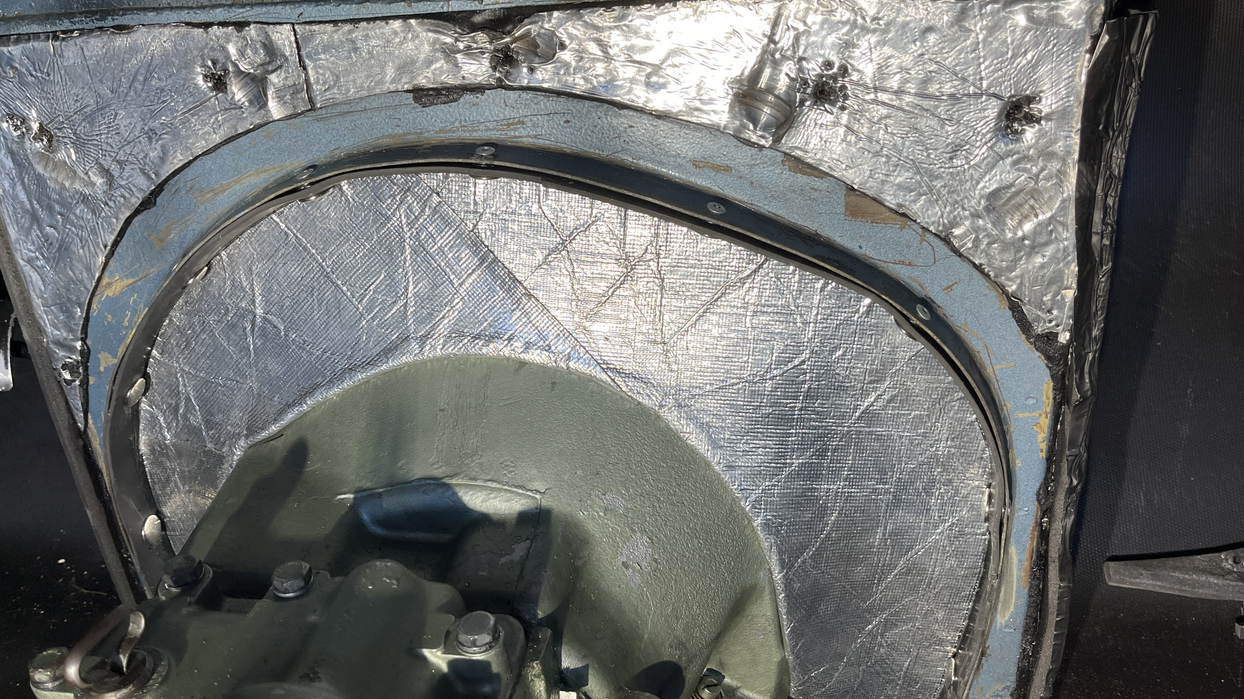

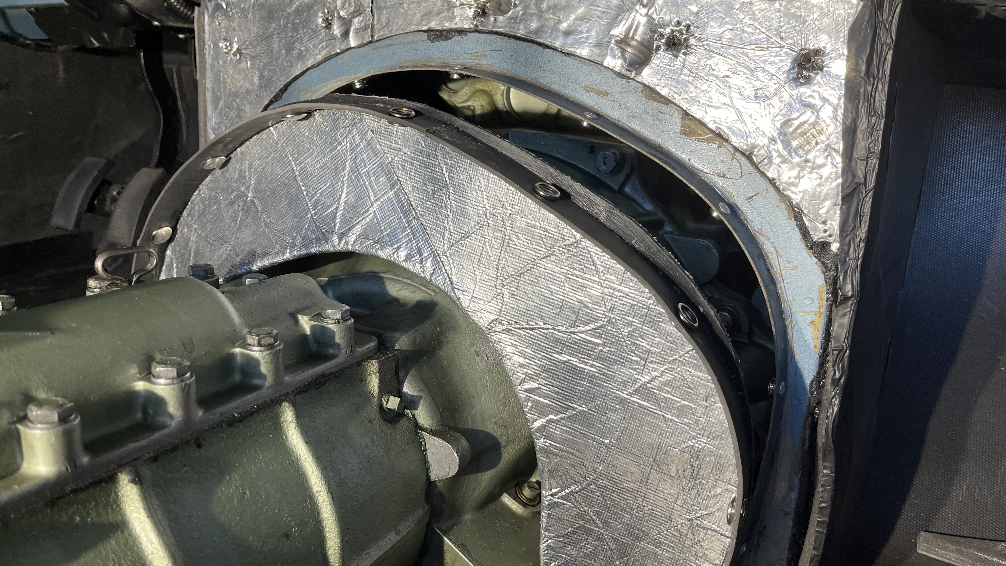

I put a radiant-shield on the metal and placed the heat panels back on top.

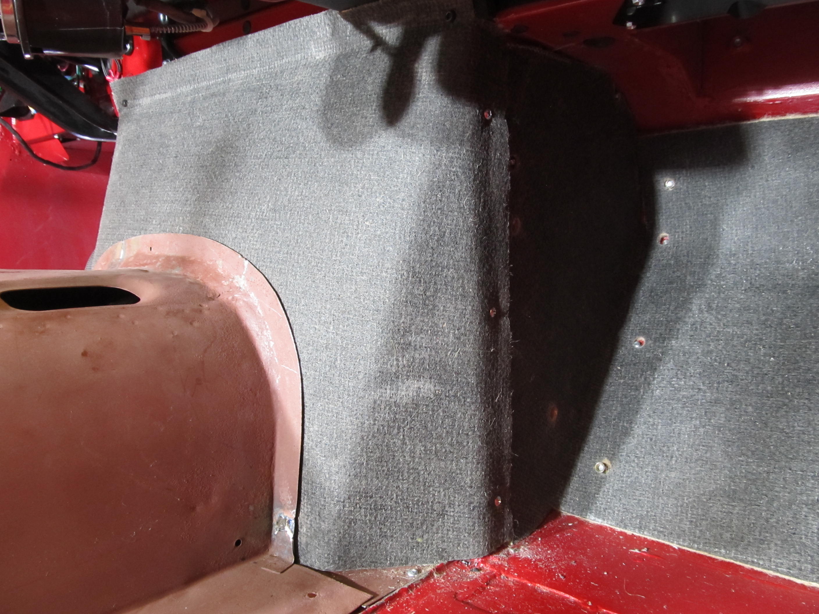

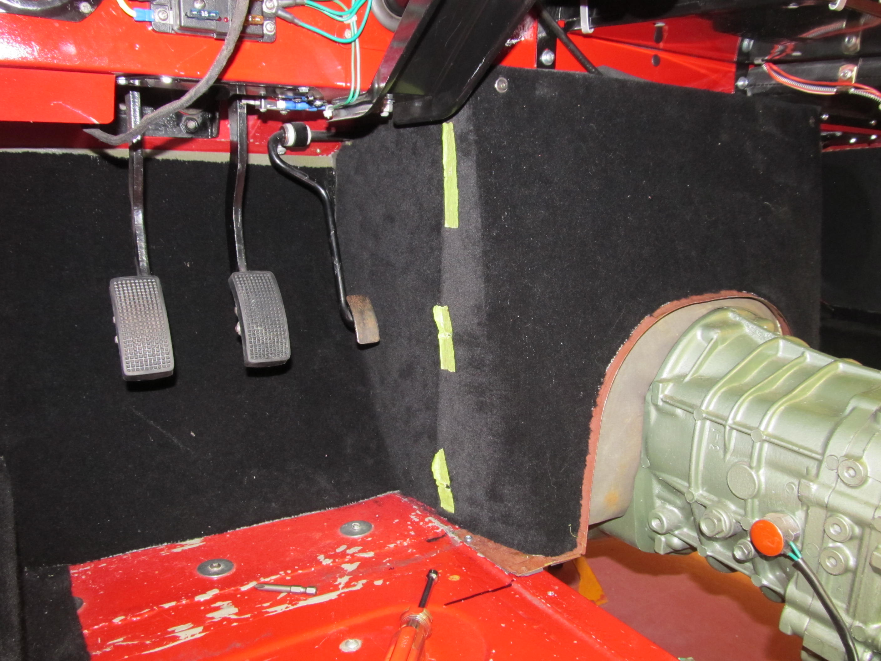

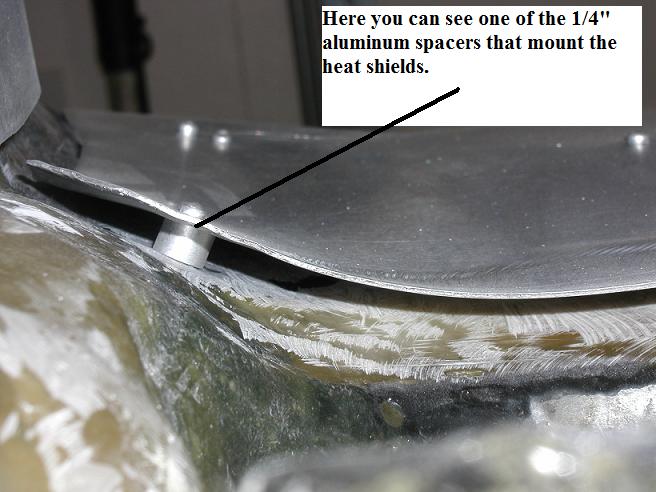

I took a similar but slightly different approach than HealeyPassion & AUSMHLY. The heat shields are not actually insulation but more 'deflectors' relying on 1/4" spacers to create a dead air space behind (especially the modern replacement non-asbestos versions) to insulate the cabin. Since the sheet metal will radiate any heat into the cockpit, I figured the best thing was to keep the sheet metal from ever getting warm (dead air space still means hot air against the metal).
I used a semi rigid foil backed fiberglass insulation typically used on industrial HVAC ducting - comes in 4x8 sheets but the thinnest I have found is 1" thick. The fiberglass is saturated with some kind of resin binder and it's really easy to 'shave' it down to 3/8-1/2" thick. I placed that directly on the metal and used aluminum foil tape to seal all edges and then placed the heat shields over it so I am not adding any to the overall thickness. I first did this on my 100-6 about 20 years ago and it worked very well so I have now got it on the BT7 I just finished. Upper interior of firewall is insulated with a foil backed 1/2 thick flexible felt insulation.

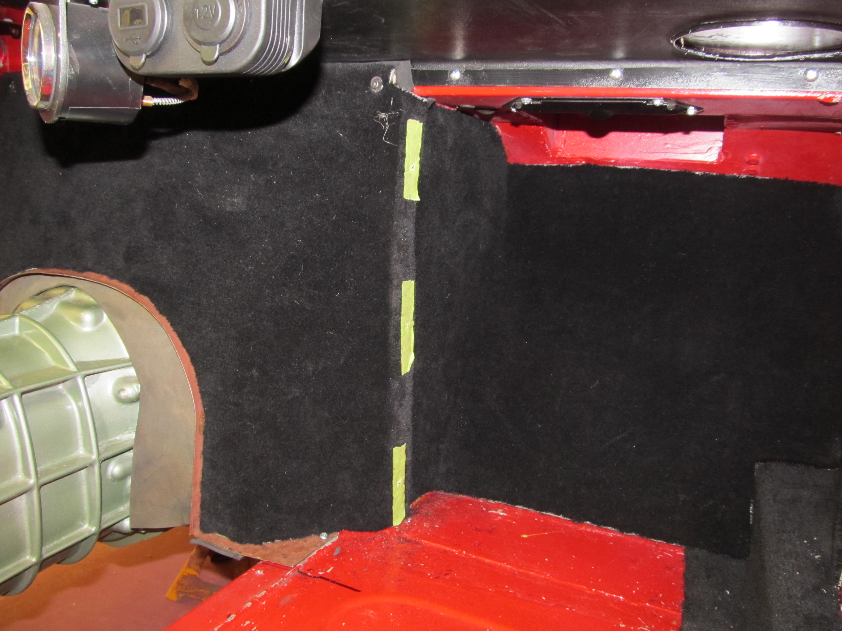

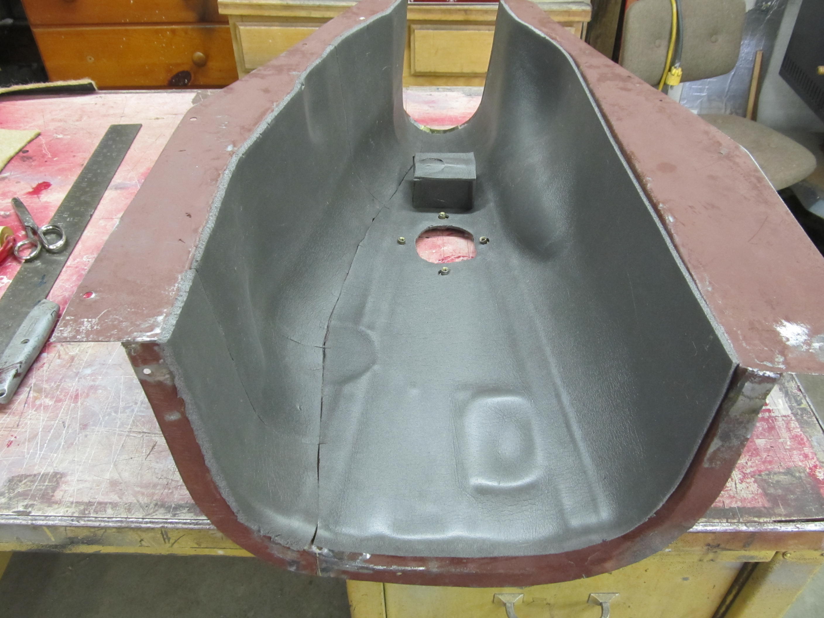

Since we have gone deep into the topic of isolating the driver/passenger compartment from heat, and Red57 added a pic of the inside of his firewall (all of which I agree with)... I'll add what I did to the firewall. First I filled unused holes (during manufacturing it seems obvious that when one hole no longer served its original purpose, they would put a rubber plug in and call it good... and as we know, rubber plugs harden and let hot engine compartment air through), then to reduce scuttle vibrations I put a heavier gauge metal backing, that is covered with HushMat foil backed insulation and finally that is covered with Second Skin Luxury Liner Pro (the same product that covers the driver's side of the car). Then, as needed, holes were added to firewall. FWIW .... or just overkill?
