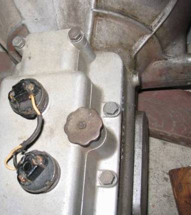

One of my TRs has the dipstick and the other does not. With a lift I actually find it easier to check the level using the fill hole on the non-dipstick box.

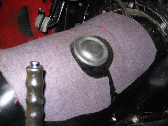

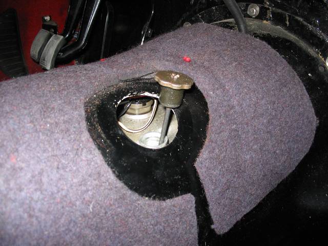

The "seal" for the TR3A dip-stick is just a piece of felt about 1/16" thick glued all around the part were it seals with the gearbox hole. My 1958 TR3A came new with the dip stick and the felt is still working just fine after 58 years and 194,000 miles.
Don Elliott, Original Owner, 1958 TR3A
I'm glad I saw this post. I was beginning to thing I had lost it. I have several spare transmissions, none of which have a dip stick; however, I thought I remembered a dip stick on my new TR3A in 1960. There was also a hole in the transmission cover that allowed access to the dip stick to check transmission fluid. Don't remember ever using it, but it was there.
