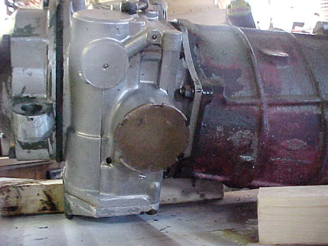

Does anyone know the size (diameter) of the larger drain plug on the gear box of a BJ8? Kragen had several 1/2 socket(?) wrenches on their rack and the larger one looked close to the diameter of the one on the Healey.
Are you talking about that big brass plug on the bottom of the overdrive TH ??-Keoke

gregw, ya i kept removing the 7/16 square plug filling it with oil even till it overflowed and the trans. still kept maken funny noises! /bcforum/images/%%GRAEMLIN_URL%%/jester.gif ya might be lookin for this-
How ya gonna get a socket on that? I've been using a block of hardwood and a hammer!

SHhhhhhh Dave, /bcforum/images/%%GRAEMLIN_URL%%/iagree.gif But, TH just might stumble on to sumpin.--Keoke- /bcforum/images/%%GRAEMLIN_URL%%/grin.gif
They have them in 3 sizes I think to 2 1/2 inches. I cannot get to the car until Sat or I would measure it. Seeing the picture anthony posted makes me think it will not work do to it needing 6 pins. It looks like the socket I've got for the rear axle which has a 1/2 drive but has geometricly placed pins.
Yes TH, I have not found anything off the shelf that readily adapts to that plug either. A small tapered piece of hardwood tapped with a hammer will probably loosen it they usually are not frozen up.---Fwiw-Keoke
P.S. You do not need all six pins if you find one where two of the pins will line up thats all you will need.- /bcforum/images/%%GRAEMLIN_URL%%/yesnod.gif
