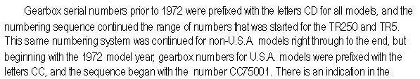

The gearbox numbers (according to the TRF catalog) were prefixed with CC prior to 72.
Where do you see that ?
Randall-I must of been having a senior moment. CD is correct, CC came later. Thanks for keeping me honest.
