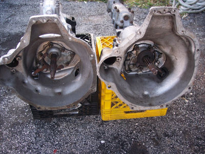

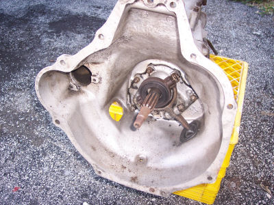

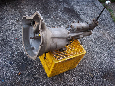

Jack, I am so glad you started this thread, as I too have a smooth-case I bought off ebay as a stand-by tranny (I have switched to a ribbed-case on my BE). Due to this thread I went out to check mine and it is also just as you describe...all backwards! In addition, the T/O bearing fork ends with a ring/loop on the end instead of a fork and clevis pin!! I will be watching this thread to see if someone can come up with an answer. In fact, I am going to take a couple of pix of mine and post them here to help with the ID! I also happened to have a spare ribbed-case handy, so I put them side by side for comparison. Jack, other than drilling, tapping and re-situating a couple or three mounting studs, it appears that a new front cover plate would enable switching sides, that and drilling and tapping holes to mount the slave!!

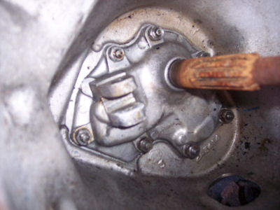

Jack, on reflection, I dug out the original smooth-case tranny to look at the front coverplates and compare them. If you have one that came in a BE, then a simple switch (no stud modifications) can be done (see pix below...bolt pattern the same but fork pivot different!)!! All you would have to do is drill and tap mounting holes for the slave cylinder mount!!

Mike in your pictures the shift fork is from a Morris Minor. The Morris had a mechanical (non-hyd) clutch. The Morris throw out arm came out on the opposite side than all spridgets. The Morris didn’t need drilled and tapped holes on the lugs because the other end of the mechanical arm attached via a fiber “ball socket” to the body via a shaft. The gearbox in the pictures is from a Morris Minor. If I’m missing something here from Jacks post I’m very sorry I can be a bit slow in comprehension.

:thankyousign: There you go Jack, we have the answer...It is a Morris Minor tranny!!
Jack the gears are the "same" just a little different in ratios. The shift lever and a few other things are also different. Glen B answered that it was a Morris box early on, I just figured I was missing something else in the question.
