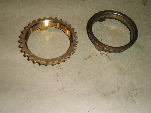

Question though, as I looked at all of the goddies in the box I noticed that the first gear syncro ring had 0 teeth. They were all ground dowm (picture attached). All the other syncro rings are OK just this one. What would cause that kind of condition?

The crunch you hear with a worn-out syncro is the dog teeth grinding.Yours have reached the next level of shot, where your mechanic starts to giggle and point...

Yep I agree MD, not only does he giggle and point but he starts listening to the kaching of the cash register.
My question to folks is what causes the nashig of teeth? Also what would be an allowable wear limit on the counter shaft, as measured with a michrometer?
A lot of fast down shifting into first would be my guess.

This is the most common area of failure and high wear. Buy a new shaft and bearings for the counter gear cluster and sleep better at night.

Yes I remember the first time I took one apart. I used the Haynes manual as a guide and found it very helpful, and I was a little set back, because if I remember right, it said to set a couple of wrenches on each side of the bearing and pound it out with a BFH . Anyways, and again if I remember right, all the syncro rings have the same part number, but the first gear syncro works the hardest because the gear ratio is not in its favor. For example, fourth gear syncro has it the easiest because the ratio is in its favor because the two gears are roughly the same size, the gear on the counter shaft and the gear on the main shaft ; whereas, in first gear the teeth travel more distance because the gear is bigger.
