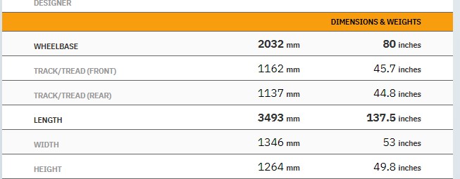

Can anyone tell me, in inches, what the inside tire measurement distance is from side to side on a bugeye? (for possible shipping info). Stock wheels/tires.
If you are thinking about a Tow Dolly they won't fit very well on the one UHaul Rents. Tell them you are towing an MGB. Don't forget to disconnect driveshaft. Leave it in the back of the tranny and wire up the Driveshaft out of the way. If you try to flat tow you'll ruin the tranny if rear wheels are on the ground.
