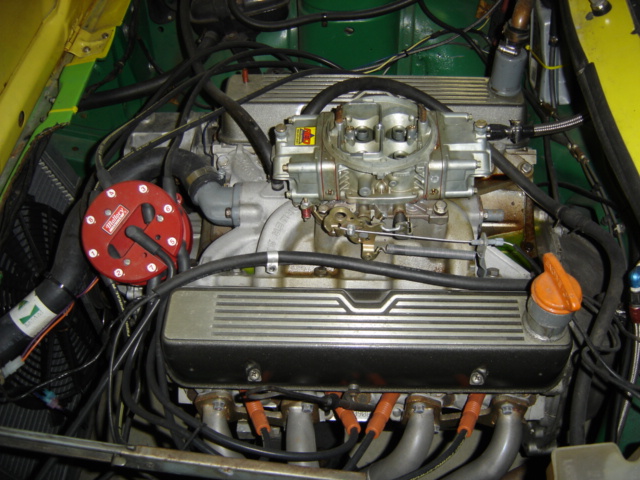

I have the Mallory in the TR8 race car, and the MSD in the BMW race car. I like them both. The main reason I went with the Mallory in the 8 is because of Woody. That is what he thinks works best, and that is who offers tech support. With a unique car like a TR8, tech support is everything. There is nothing more frustrating than calling a tech line and they say "You have a What? With a What?"
Nope - the Unilite is "Plug 'n play"! Works like a champ.
