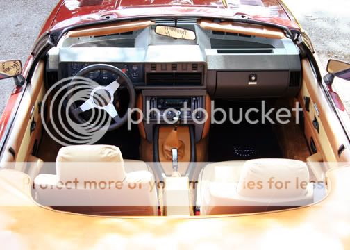

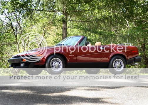

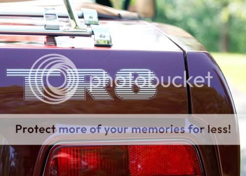

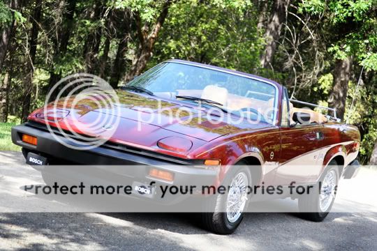

Just some more pictures and questions. Should I change my power steering fluid? How and what type of power steering fluid should I put back in? If I flush my radiator, is there a drain on the engine block? Where is it located. I've changed all my other fluids. I have a manual, but its on CD and searching through PDF files is a PITA!

And, again, that is one lovely 8!
Larry, stop putting up pictures of that car on the forum.
You are giving me a stomach ache.
Makes me want to go slap my wife. On Mother's Day yet.
One fluid change I would highly recommend is synthetic transmission fluid. I noticed a significant improvement over the petro based stuff. I used Pennzoil I think but if you want to spend $11-12 bucks a quart you can go with GM Synchro.
Gotta say it again - beautiful car.
