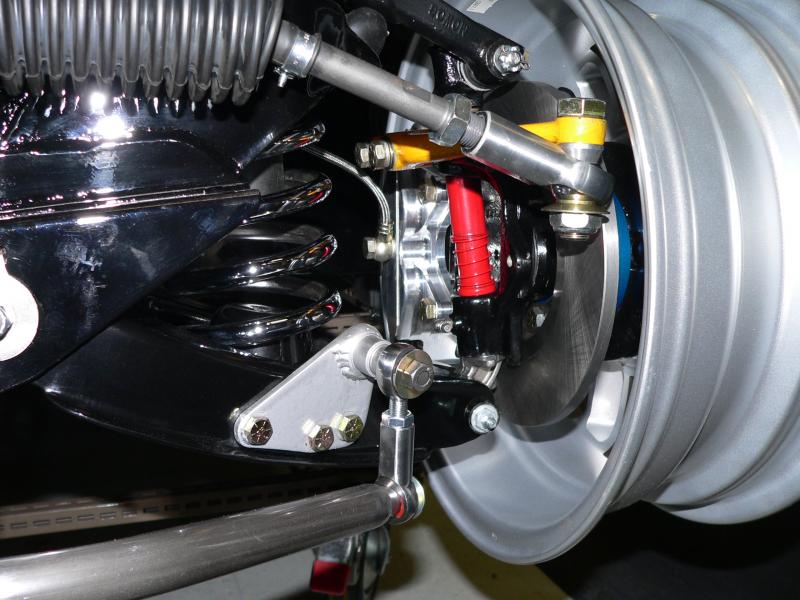

Gerard, not planning on redoing my brakes but am curious as to who Steve Christiansen is and what his brake kit consist's of?
Kurt.
You'll note that he is using a Marina hub. I guess these are available as repros? Or he is sourcing good s/h units.
I just checked the web. Marina hubs have different bolt pattern, so I assume he is sourcing the hubs manufactured for the Morris brake conversions.
Kurt.
He makes a variety of aftermarket parts for a variety of cars, including rear disc brakes setups. Here's the Midget page.
https://www.olphartz.com/midget.html
I looked into his machinist making my 5 speed kits. The guy is quite skilled and makes some very high end parts for some exclusive customers.
