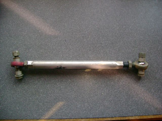

I ordered up the pieces to put them together over the weekend. Once I get them and screw them together, I'll snap a photo. Right now all I have here is ones with standard rod ends. They are the spherical steel bearing type and were on one of the TR8 race cars. Some people use them on street cars, but I find them too harsh for a road going car. I'll go out to the garage an dig them out and snap a photo. They won't have the bushed rod end, but you can get the idea.
Here is what they look like with spherical rod ends and aluminum spacers.

I am still waiting on some pieces. I decided to make up a couple of lower control arms with adjustable spring perches while I was at it. I have parts coming from 4 different places. As far as the top bars go, I ordered aluminum tubes from Afco. Stock length is just over 17" center to center, so use a 13" rod. The rod ends will make up the rest of the length.
https://www.afabcorp.com/AFCO_Dynatech_US...e=hp_alum-tubes
The bushed rod ends came from the site I posted above. You will need two right hand and two left hand threaded rod ends. Go with the 3/4 16 threaded ones that are 2" wide. They will need to be cut down to 1 7/8 wide, but thats not a big deal. They only come with a sleeve that accepts a 9/16 bolt. Stock rear mounting bolts are 7/16. You will need new sleeves or drill the mounts and use larger bolts. Just screw them together and mount them on the car.
