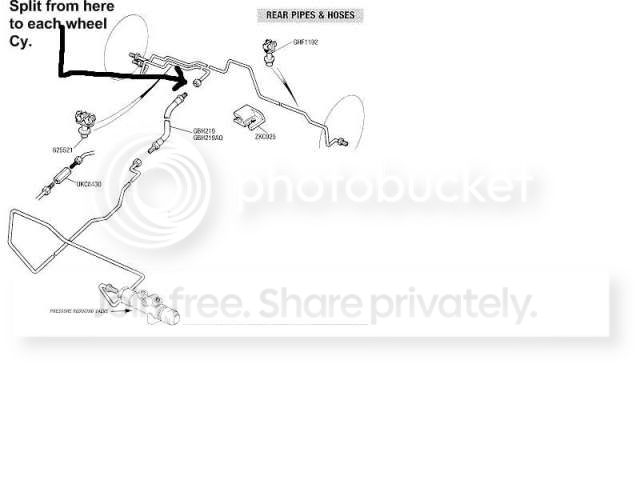

Monica- While he's at it. Split the rear brake lines and run a separate line to both.
The factory only has 1 bleed screw back there.

Don, splitting the line. I so don't get it. Please explain why I should get this done. To get a 2nd bleed screw there back there? Does it affect braking performance or is it for ease of repair later? My apologies for my lack of mechanical understanding :blush: , your patience is appreciated.

Monica- The rear brake line comes from the front ober to the passenger rear drum and then to the drivers side where it it ends and you bleed it from there. A lot of connections to trap air. If you split it from the rear axle to each wheel cy. you can then bleed each separately.
It's to real expensive to do but it can wait for another time too if money is tight.
