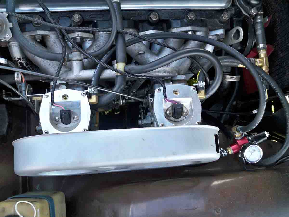

I was at the Roadster factory Party last year and there was a guy that had a TR6 with a EFI conversion for the Stromberg carbs and he loved it. You gut the carbs and place in a insert with an injector and use the Stromberg carb body as the throttle body. very simple, straight forward and reasonable. Don't remember who made it but some one on the forum should know.
