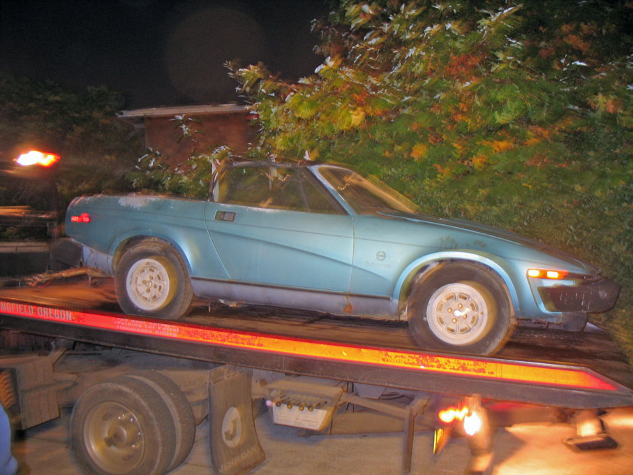

side by side, my v8 subframe from TSI and my TR7 subframe look identical, except for the motor mounts. the steering rack has to be mounted inside the motor mount bracket. The rrear tranny mount is different to account for the longer block, driveline length difference also. TR8 has larger front brakes. the radiator mounting is different, the top of the radiator is inclined to the nose of the car and the lower radiator mount is different. Both use the LT77 tranny. You could do what I did and purchase a TR8 parts car (body is rusted out) for all those little parts.
