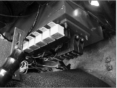

I've seen his web page and honestly I didn't like mounting the relay box under the hood. I found a pic of the relay mounted UNDER the battery box (I'm attaching the pic). I personally think this would be the way to go.
I wouldn't even consider Advance unless the product could me made to look a little close to stock.

There are two schools of thought on mounting the relay panel. One school says that if you spend that much time installing it, and it's such an improvement over stock, you want to mount it where everyone can see it. The other school says hide it to keep the car as stock looking as you can.
For the later school, we recommend turning the panel upside down and mounting it in the same location as on the above mentioned web site, but hang it underneath the shelf. It's easy to get to there if you ever have to change a fuse or a relay, but it's out of site unless you are looking for it.
