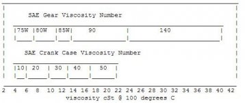

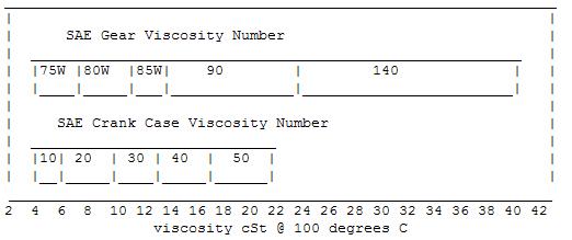

It is worth nothing, perhaps, that gear oil is rated according to a different system than motor oil, so 80W90 gear oil is about like 20W50 motor oil. I prefer straight 20 weight, but it is getting hard to find for some reason. gear oil.JPG
