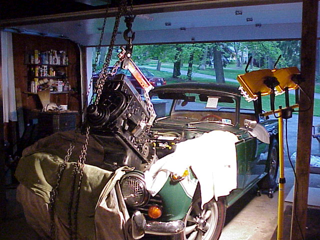

You might consider doing this
That's a scary picture Frank. Do you have an "I" beam across your garage? If so, that is really cool.
The only good ones are the ones that are going back in.
No not a steel I-beam, but I did erect a temporaty "bridge" from 2 6x6 uprights and a triple 2x10, all pressure treated. This was a few years ago and that lumber is now part of my daughter's deck. :smile:
I just looked "up"... VERY similar to Franks set-up. A pair of 2x8's glued and bolted, resting on a CB wall at one side and a 4x4 at the other. MGB, Lotus and Alfa engines with gearboxes attached have been yanked out, swung about and reinstalled over the last two decades with that. So far, so good... no deck plans here, tho. :wink:
Now that project would definitely get me into marriage counseling.
I can hear it now:
"You told the carpenters to stop working on the kitchen and bathroom to do WHAT????????"
