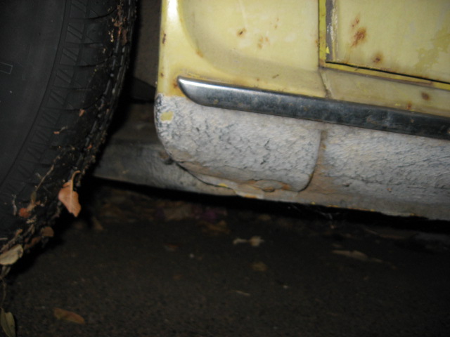

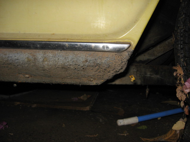

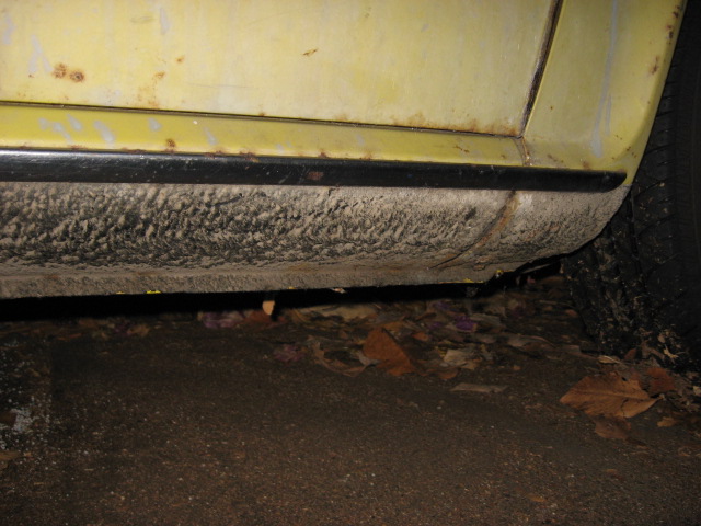

Here's what my unrestored 74.5 looks like; I have no reason to believe they were ever redone. The rocker finish is (was) black and looks pretty rough texture-wise.
Jeff
