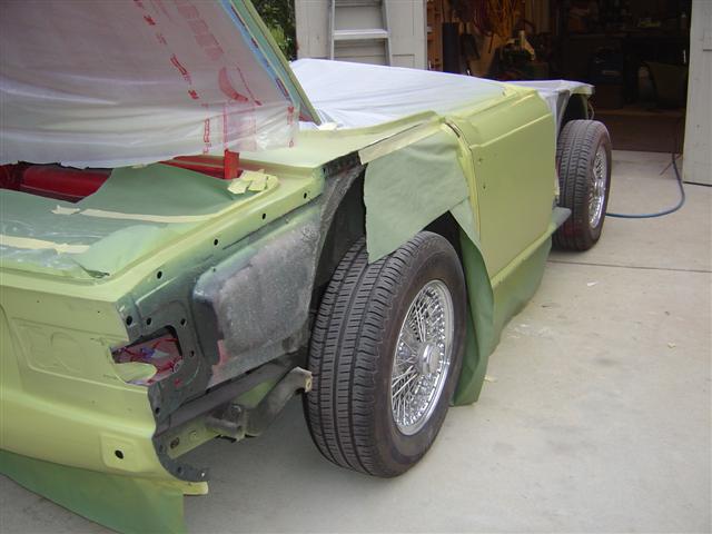

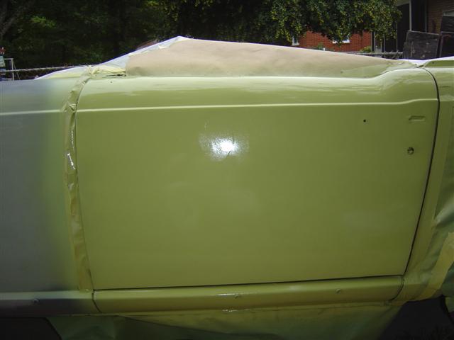

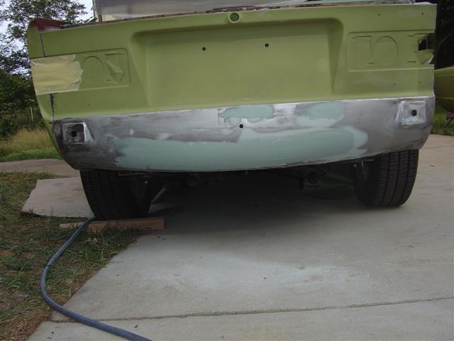

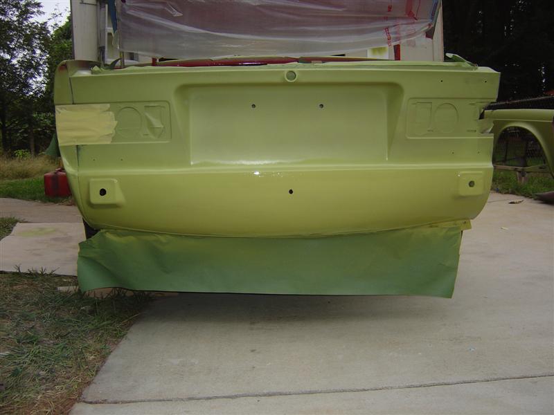

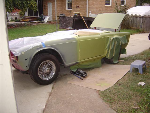

OK for your viewing pleasure, just completed today, boy my body hurts, this hurts and is tiring too, all the paint removal is done, the major plastic filler done, now the block sanding for low spots is next see pics for all you visual guys, ooo I am a visual guy too, thats right I am from Mars and not from Venus

I would do a fender after work every night when I am not traveling, and all day saturday and sunday, took a break on Saturday to go out, Raining today but I am traveling this week so back on it Thursday and this weekend,
