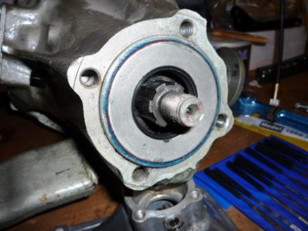

I replaced the pinion seal on my diff a few months ago. The original seal is leather and will leak due to its age.
One word of caution.... use a seal puller to remove the old seal. Don't be tempted to use a screw driver as you run the risk of scoring the wall.
Here's my new seal installed...
