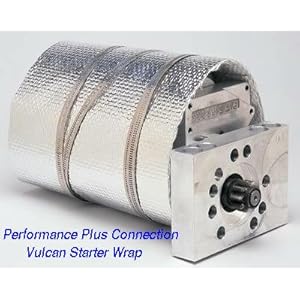

Yes, starter solenoids frequently don't work properly when they get hot. I don't know all the reasons why, but there seem to be multiples (including that the winding resistance goes up with heat, meaning the current and hence force goes down).
A new starter & solenoid may or may not solve the problem. I'd try adding a heat shield to the starter first. Ordinary "roofing tin" will work, if you can find a way to secure it so it doesn't vibrate and break; or you can go with something like this:
https://www.amazon.com/Universal-Starter-Shield-Reflective-Mylar/dp/B004MHTWWE
