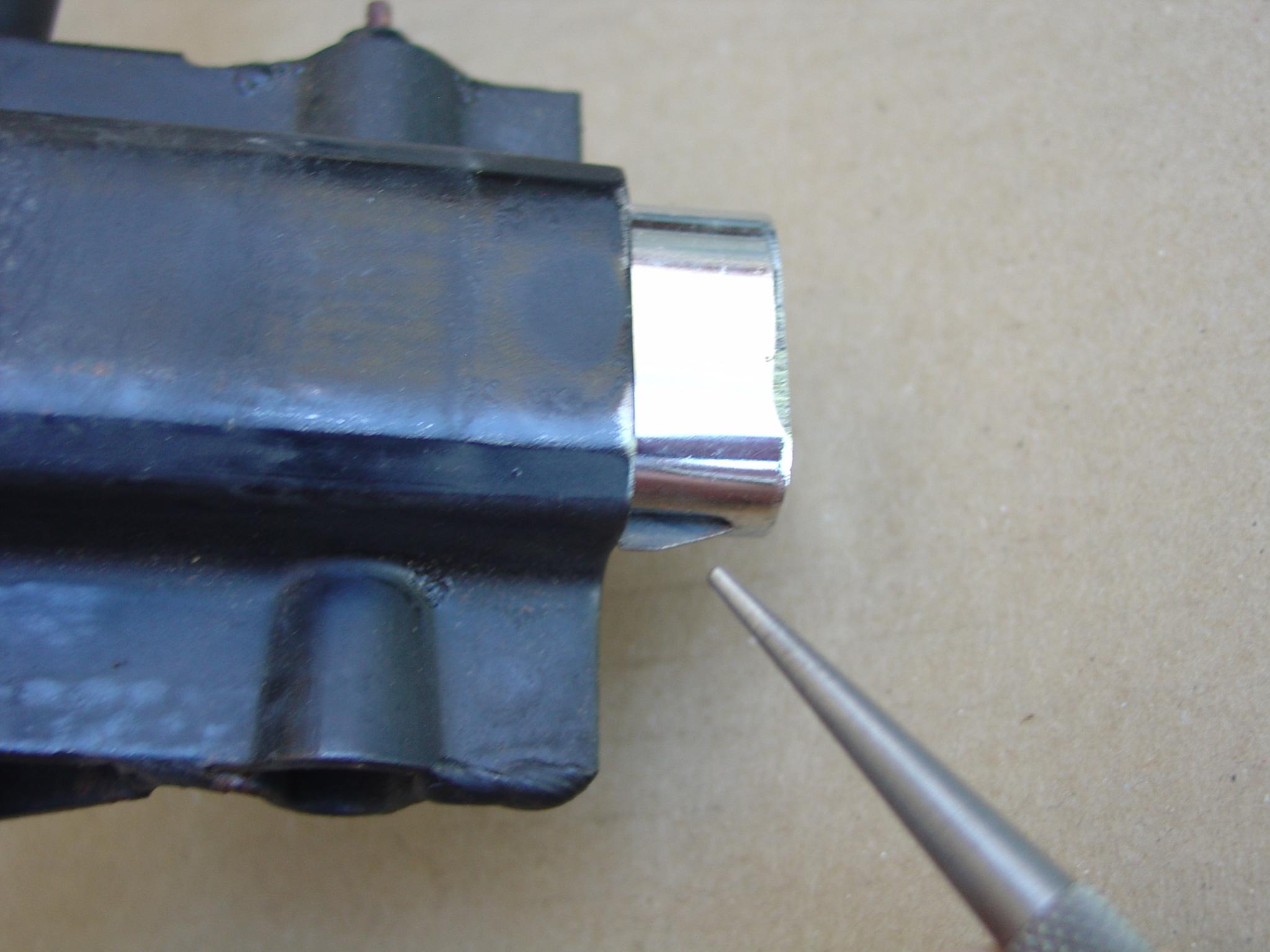

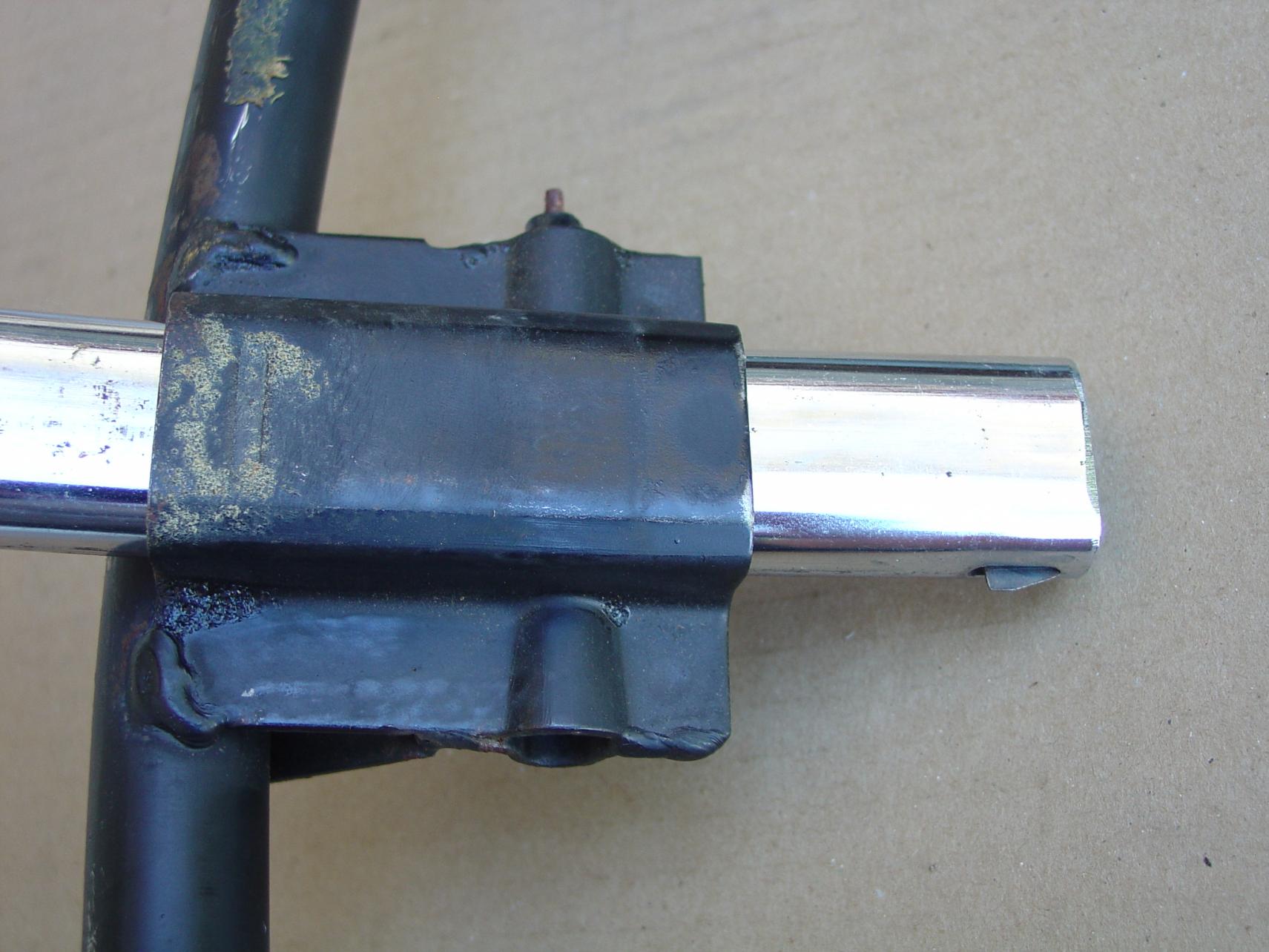

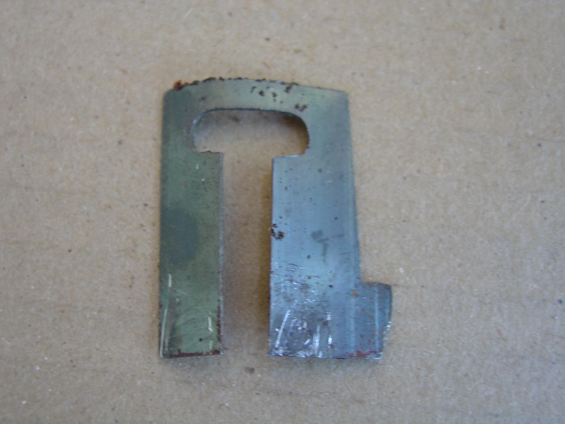

SC, thanks for the information. I ended up stripping down another seat that I'm going to restore. After studying how the head rest goes into the seat, I've determined that there is no tool that can be inserted to release it. What you are suggesting may work if you don't punch a hole in the back trying to release the tab. The tab is located on the side of the headrest shaft. What I thought I would try is undoing the bottom of the backrest vinyl and reaching up the inside with a vise grip and having someone pull up on the headrest while squeezing the tab in.
I was unable to remove the headrest as described by SC's posting. The problem I ran into was the seat back foam prevented me from pressing on the tab when the headrest was pulled all the way up. I had to go in from the bottom of the seat and using a needle nose pliers was able to remove the spring tab and then pull the headrest out. See attached pictures. It turned out to be more work then I counted on; but if your headrest is cut, torn or the foam is rotted this is one way of replacing it.
