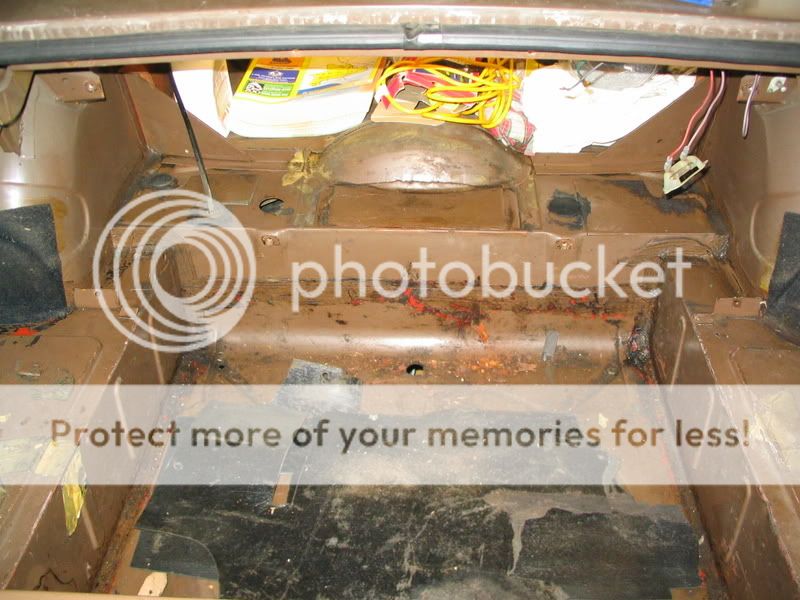

Starting my second year of TR6 ownership, (w/ a total of 12 miles on the odometer!), I've wanted for a while now to pull the gas tank and have it boiled out. Thankfully, I was able to pull it out this afternoon; it's a lot easier on the '6 than the '3! I'm going to use Randall's recommendation, Mac's Radiator in Bellflower, CA. My local radiator guy mentioned them, too.
For those of you who have renewed your tanks, a couple questions. There are 2 strips of spongy material, 22 and 29 inches long, glued to the tank. Did you renew those strips, and what did you use? There's also a 7x12 inch pad under the tank, some kind of rubbery material, with sponge-like material underneath that. Of course, that spongy stuff crumbled away. Did you replace that, and w/ what? I found a TRF kit for that, but it doesn't seem to be available....
I'm happy with the internal structure of this car, nice and solid:

My car ('72) had a horse hair pad under the tank. It appeared to be original. I don't believe I reinstalled the foam padding strips. I don't recall them being on that tank. Probably lost to that AZ sun.

The purpose of all that stuff around the tank was for sound deadening.
Go to big box hardware store and get thick weather strip insulating self adhesive tap. No harm in putting it back on.
Your boot area looks pretty clean as far as rust is concerned

Hey Kevin,
My trunk and fuel tank were badly Pedro-ized. I stripped
everything down to bare metal, dealt with the rust and
restored the trunk. I used white 60 mil thickness TPO,
fleece backed roof membrane I got from a buddy who is in
roofing.
I installed the TPO with bonding adhesive, fleece side
upward. It cost me a Greek giro and a diet coke! My trunk
was far worse than yours. You have an easy one!! Good luck.
