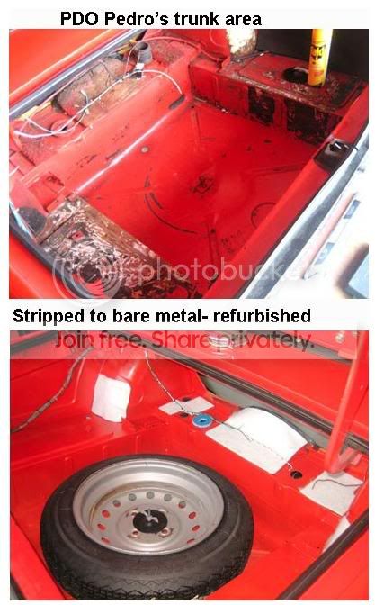

Perhaps this will give you a general idea
of the gas tank area and pads.
Dale(Tinster)

Did you make those "gaskets or pads" and if so, what did you use for material? The blue one looks different from the others.

<span style="color: #990000">You'll probably laugh. I was fairly certain the gas tank area was
original and Pedro had not messed with it. It was in awful condition.
When I found beat up pads, I tried to duplicate size, texture and thickness.
The white is a 60 mil tri-polymer alloy (TPO) sheet with 60 mil fleece
adhered at the factory. I got some scrap from a local roofer- Brand name
<span style="font-weight: bold">Stevens TPO.</span>Most professional roofing Cos. carry it and have scrap.
Now you'll chuckle. The closest I could find to the tank outlet pad was a
kitchen sponge with that blue or green scrubby side. I cut the diameter
and then razor blade slit to proper thickness. Sharpened a copper pipe end
to punch the center hole. Here in the tropics we learn to be creative with what we've got.
later gator,</span>
