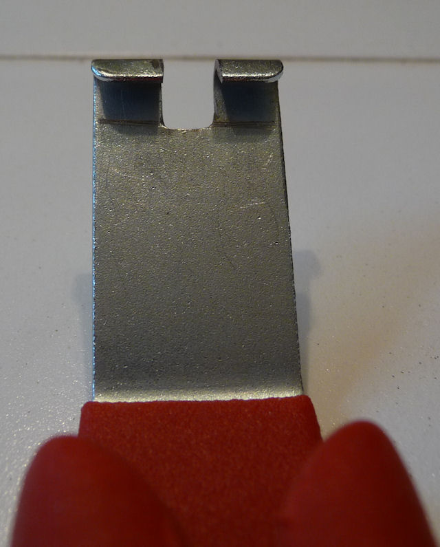

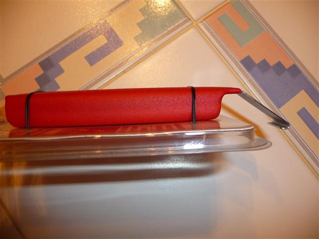

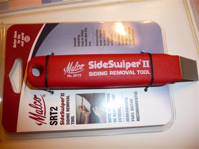

Here's a walk-through for installing the inner & outer seals. It's actually pretty easy once you've done it. I bought the Moss tool which "worked" but wasn't worth the money. If you have a Home Depot nearby you can pick up this siding tool that costs $5 and is much better made and works just as well.
Let me add to my previous post.....I've done this a bunch of times and it's not that difficult with the right tool and a little patience.

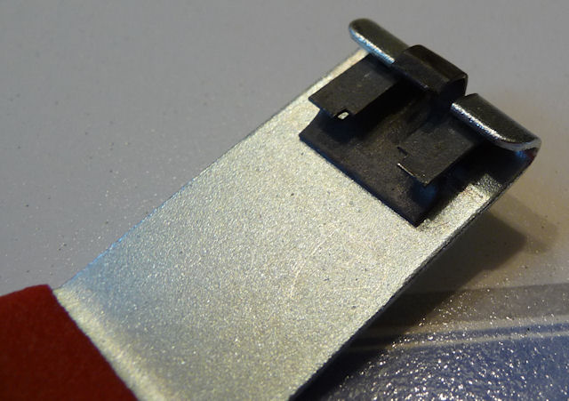

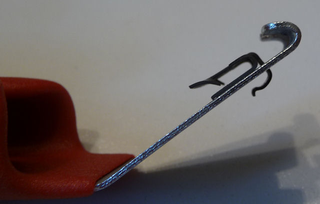

The Tool I showed up above has to be modified for the inner seal by cutting slot in the tool to accommodate the small clip. I used my grinder with a cutting wheel to do this.
Using it this way lets you pull it up on to the door panel.
And this way helps to get it on the inner seal itself....imagine it's already on the door.

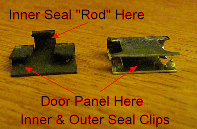

The clips themselves are specific to the seal and the inner clip on the left has an additional small clip to hold the inner seal.
It's hard to get a picture of the inner seal clip once it's on the car but here you can see how the clip fits over the door panel. The seal itself is on the small part of the inner clip
