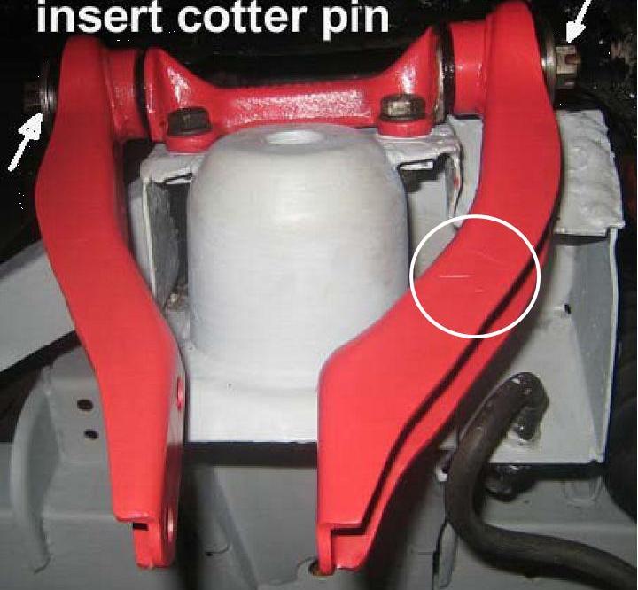

Just a reminder the upper A Arms come off in singles and can be mixed up so mark front and rear with tape and a sharpie, I got mine mixed up and reversed and took me a while to figure out what I did wrong.
Hondo
Hondo... I believe the upper arms are marked from the factory. It's been a while since I had them out, but if I remember, they are stamped "F" and "R"...
Elliot - Just put my front suspension back on. The upper arms on my car were not marked that I could see(And I looked). Kevin - It is easy to forget which parts go where and which way, do one side at a time and mark parts front, back etc. I had not rebuilt the front suspension and it's like someone said above 50% is just getting the courage to give it a go - so just do it it's not that hard. It's a great opportunity to fix it right where maybe you don't have to fool with it for a long time (that was my thinking so I did all new nylatron bushings, upper ball joints, shocks, outer ball joints and welded in the needed reinforcing plates on the lower A frame attachment points (highly recommended)). I made a spring compressor that looks identical to Randall's, works fine.
Bruce- I don't know if you're talking about a TR4, but on the TR6 they were marked on mine.
Here's a photo that I got off "Tinsters" how-to re-do the front suspension. I placed a white circle around the Rear upper A-arm and it shows a "R" stamped into the A-arm. It might be hard to see in this photo, but it's there.
