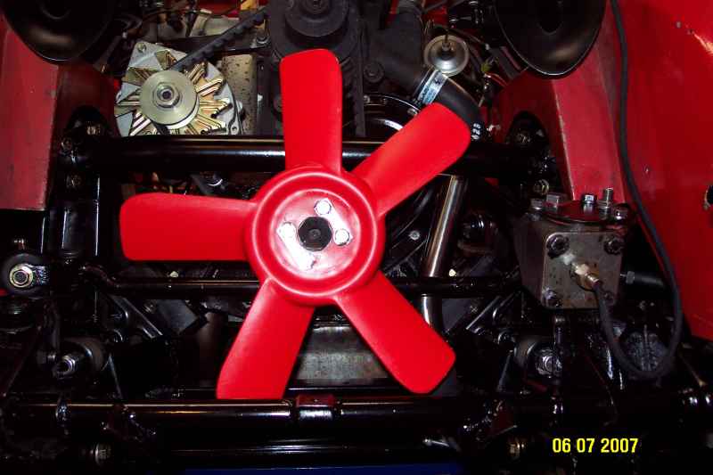

bmwfan_front.jpgThis is what I have on my 58. It's a BMW 2002 tii fan recommended by Christian Marx who raced with one at the time. I had to bore out something but was easy to do since it's plastic. Works well, fit perfectly, and yes it IS balanced despite the awkward looking blades.

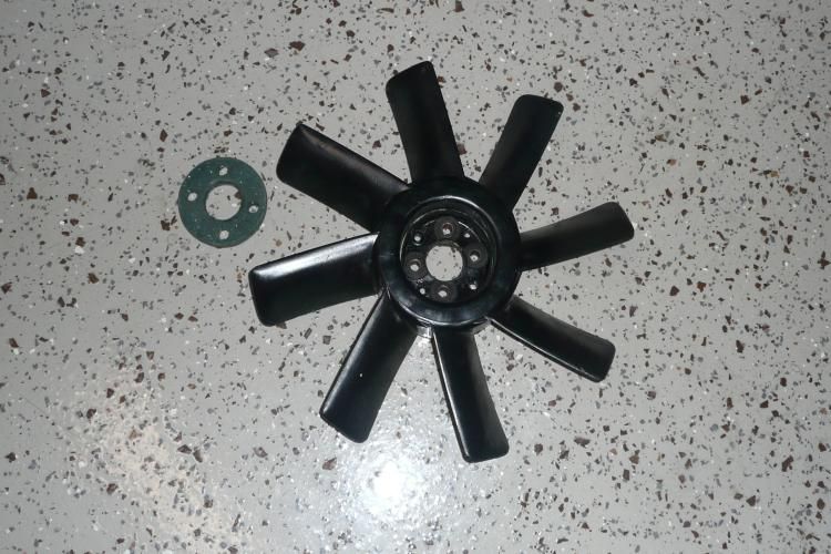

I have used a TR6 fan (backwards) and needed a spacer to get it far enough forward. Made from a piece of cutting board, looked like this (fan painted black for stealth):
Reversing the fan does still blow the air the same way (just as a nut will screw on no matter which way 'round you use it) but those blades seem to have a slight airfoil that I suppose makes them somewhat less efficient operating in the opposite orientation.
