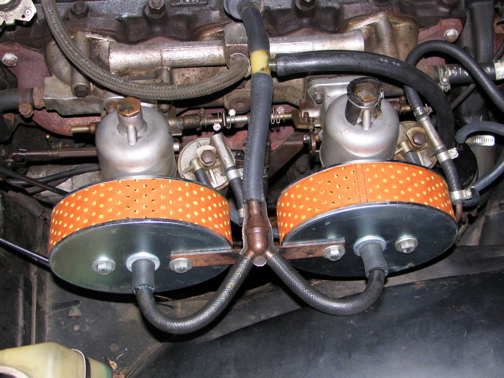

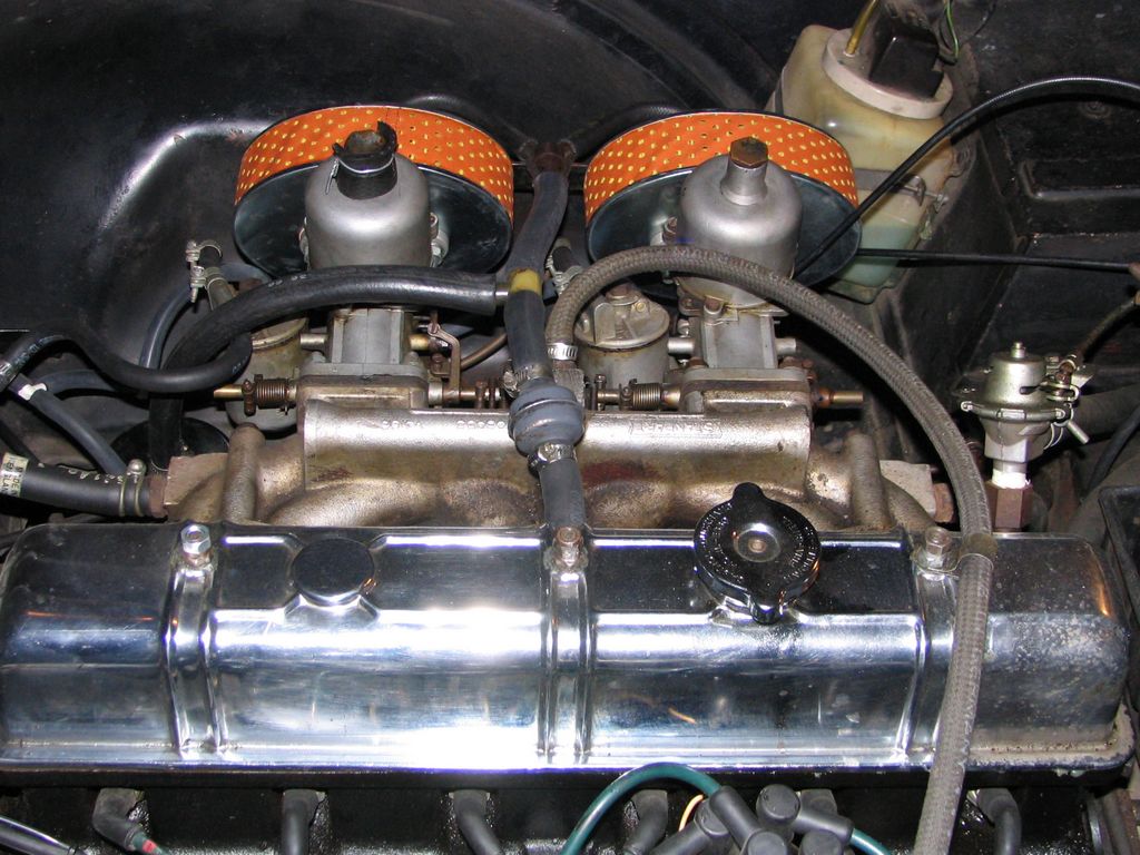

Wanted to followup and let you all know what I ended up doing. I bought 2 inexpensive replacement paper airfilters (Indian made), and ported them using some pipe fittings from the hardware store. I am shooting the crankcase vent into the front side, like the TR4 setup. I'm attaching a pic of what I have- nothing fancy... Anyway the car seemed a lot happier with a fresh set of filters- it was definitely time. I am thinking about exploring PCV options some time. The grey piece in the line is just a gauze flametrap.
Thanks again for all the insights. All input welcome! Pete
