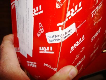

I have one from TRF (TRW Brand)in the 250. It came in a box labeled, "use of silicone brake fluid voids warranty". I've been using silicone in this system for 2 years. I have noticed no change in performance.
I wouldn't worry about the silicone fluid thing, unless you're really concerned about a warranty! :wink: Meanwhile, TRW is [one of]the official successor to Girling/Lucas. (I'm using the brackets because I've heard that there is still some more or less "official" Girling manufacture in India, but I'm not clear on what branding they use.) Anyway, a TRW-boxed master cylinder is as close to OEM as you can get, since it essentially IS the OEM product.
