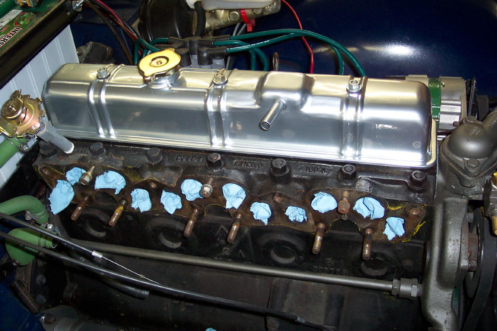

I had mine powder coated locally. They call it "near chrome". You should be able to find something close. It's a very shiny silver. (I have tried to attach a picture)

Here's the powder coated 'near chrome'.
