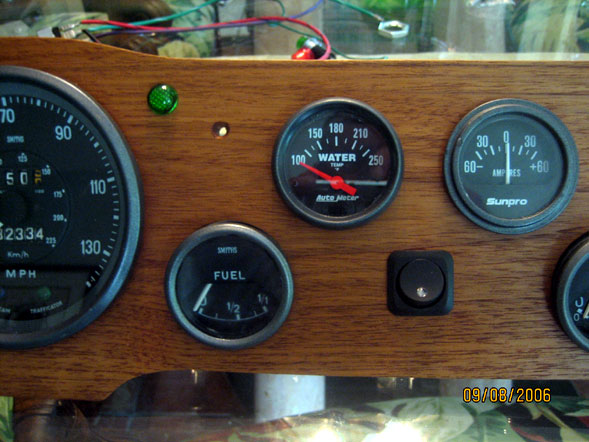

Here is a photo of 2 aftermarket gauges, dry fit at the moment.
I am this week at the tail end of refurbishing the
originals but needed an aftermarket for the new
electrical system I am installing and my original temp gauge was broken. Replacement TR temp gauge also did not
function so I bought aftermarket. It functioned just great
for the 18 miles the TR drove before it died.
Hope this helps

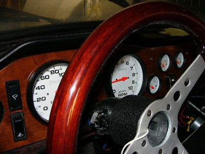

I actually did a dash conversion to white face guages on a past tr6. If you want all original size guages I found only 1 brand auto meter brand Phanthom series has all the right sizes but some required some work as for instance the speedo, or the tach, was electronic. I don't remember everything but remember having to get a different gas tank ending unit, and some part that hooked up to the transmission for the speedo. Auto Meter tech service got me in touch with everyone I needed for the proper sending units etc.
here is a second photo of the Auto Meter Phantom guages.

When I did the dash about 3 years ago or so, the Phantom series was the only series that had both the speedo and tach in the correct large size. It may be they have other series and styles with all the correct sizes now, but I liked the white faces.

The white guages are very cool against the wood dash, and when you are done look custom. The black would look too much like stock. if your not a purist, and want something cool go for the white. These guages aren't cheap, and it's a substantial job to change them out. I was very happy with the look. I wish I had better pictures than those posted.
Another thing to consider - If you use the white face gauges, you WILL need to use a gauge light dimmer! They are BRIGHT!
Having a gage light dimmer with the stock gages in a TR6 is an oxymoron. The white gages do look good, I must admit and against a dark cherry or dark walnut dash, they would be outstanding.
