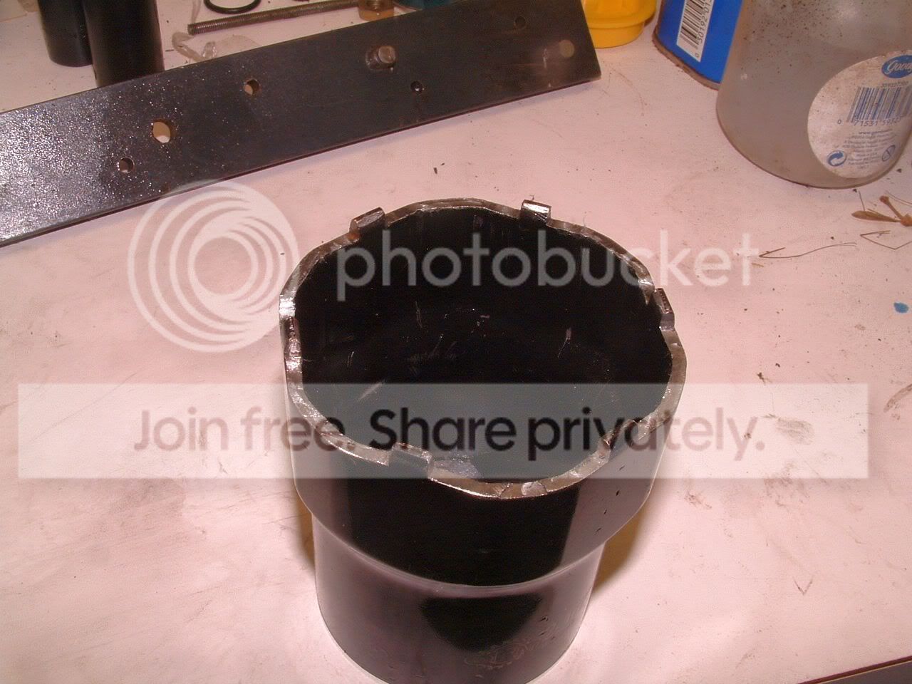

Personally, I don't like the tool shown in your link, as it only grabs one tooth and may distort the soft brass plug (leading to leaks) if it is stuck. I made this one myself (that grabs all 6 teeth) from a big socket ($10 on eBay), but I believe someone is selling them commercially.
In the background you can see my previous tool, which is just a heavy piece of flat iron (Home Depot sells it as stakes for concrete forms) with two holes drilled and tapped; plus two bolts filed down to fit the notches securely. It works OK, but can be kind of awkward under the car.

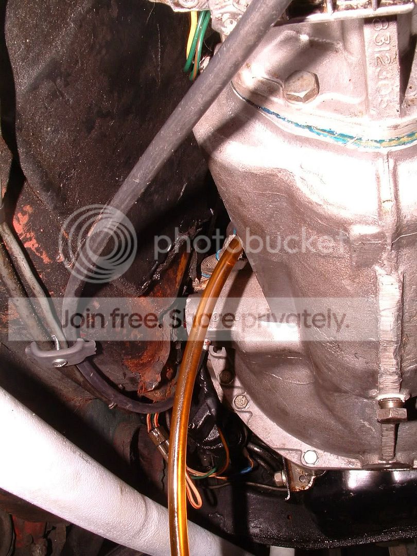

I fill mine this way, use minimal pressure otherwise you will have a terrible mess.
