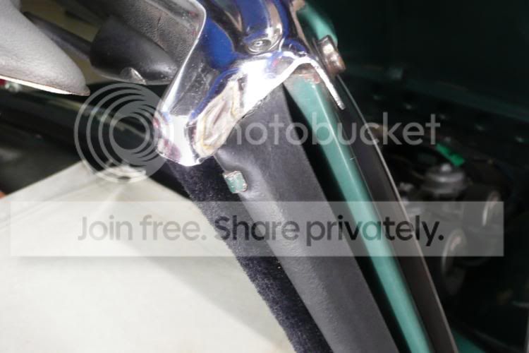

Im starting to install the door weatherstrip and Im not sure how to install it around this clip. What is the purpose of this clip and how close should the door glass be to this clip? Also how far up to the top side of the windshield frame does the weatherstrip go? Thanks
As found on my TR4...
The flap along the top edge of the door window should have a wire loop (long rectangle) that hooks here. Replacement tops usually include that wire & rivets (2 per) but leave it to the installer to attach them.
Full agreement here. Those are top retaining clips.

The clip resides behind the weatherstrip, so it should not touch the glass, when the window is up.
