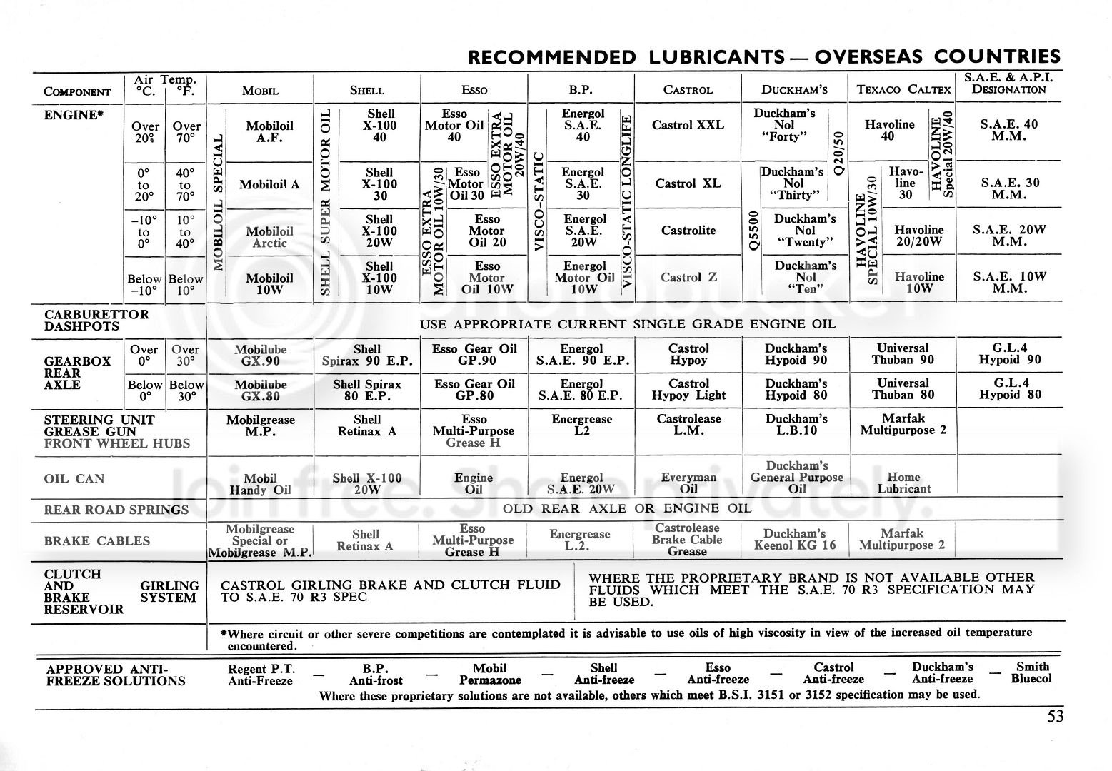

Ive read where some people use 90w gear oil in the steering box but the service manual says to use grease which I assume is the same as whats is used for the tie rods and ball joints. Which is correct? Thanks
Another question. Should the boots be filled with grease or put back on empty? Are the boots just for keeping dirt and water out? Also how much grease should be pumped back in the r&p after boot removal? Thanks again.
