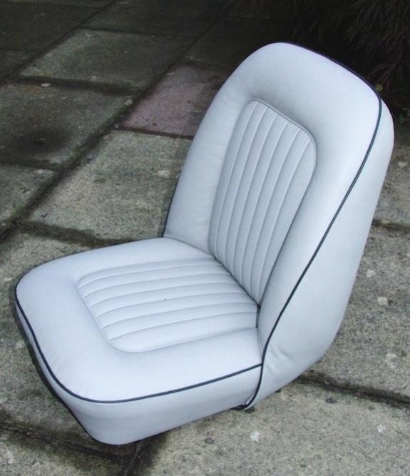

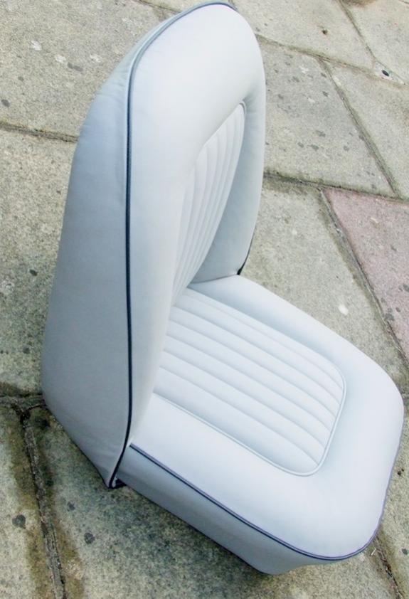

After a lot of effort on the foams, rebuilding the frames and learning how to work leather here is the result.
The covers came from John Skinner in the UK who supplies some of the usual outlets. These fit EXACTLY.
But the usual foams are poor and need a lot of work, especially for leather which is more demanding on the foam size and shape.
Many thanks to the previous poster for the tips he gave. ALL of these are right and ALL were used and needed.
I owe you one buddy.
It took almost 1 PINT of glue on each seat, 1 litre can in the UK these days.

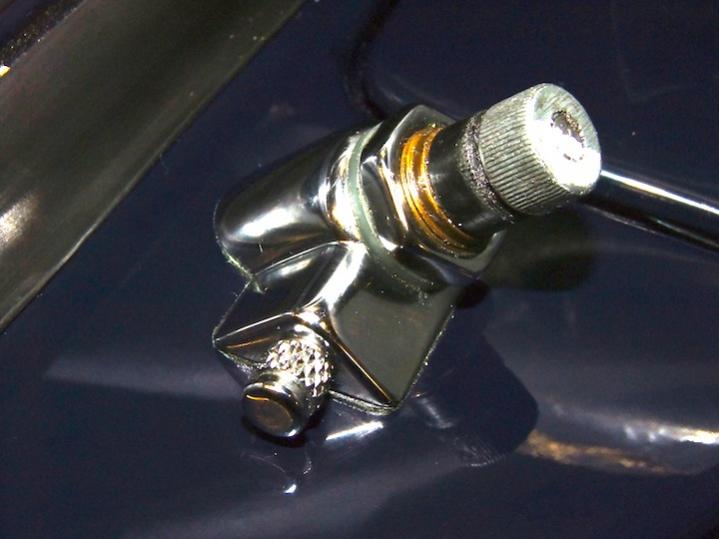

Thanks for appreciation. This is the last job in a total restore of a "basket-case
You might like the wiper-jets made in brass by hand.
