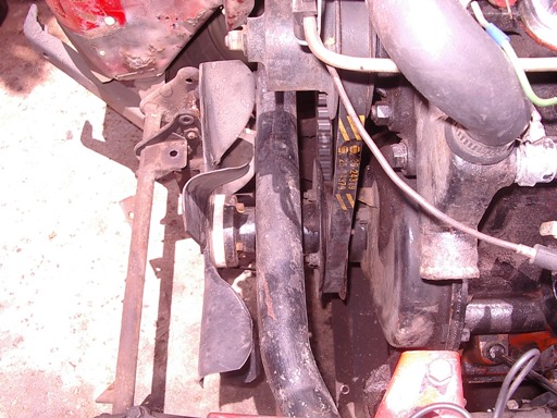

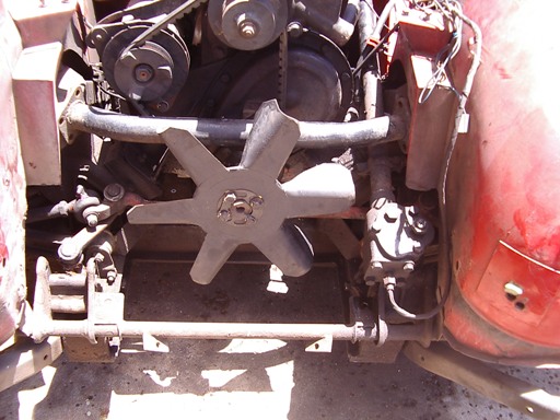

I don't have a TR4 but in my TR3A i use a polymer fan from NAPA. It is a black six blade fan with flexi-blades that are suppose to loose pitch due to centrifugal force at higher RPM. It required some modification to mount. I needed to reduce the overall diameter from 14 inches to 13 inches for clearance. I used an Xacto saw for this. I also needed to fabricate a spacer about 3/8 inches thick to move the fan forward to clear the cross tube. I used an old nylon cutting board to make the spacer. The original fan mounting hardware was used to attach the fan and spacer to the fan hub extension. The fan works very well at low RPM and in stop and go traffic keeping the car cool. Here is a photo of it installed.
