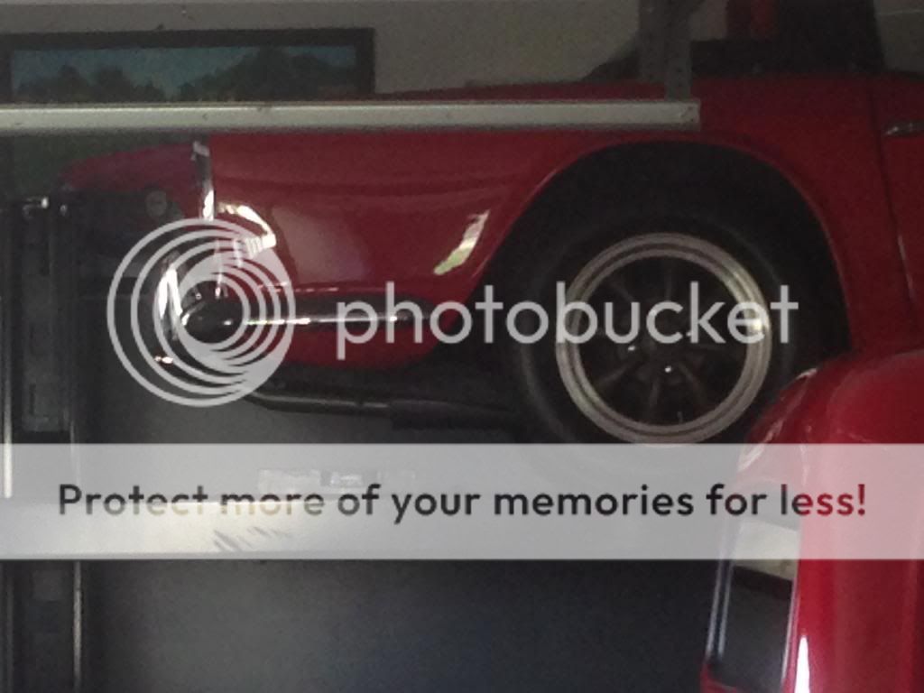

Alex, I have them on my TR6, "Y" pipe and all, but I had to bend the "Y" down to clear. The mufflers are a flat oval and I would guess 22 inches long but the rear pipe runs under the rear almost a foot and turns up.
