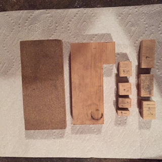

And here's the simple jig I made to stamp a replacement:
Generally it seems to be okay - but save the original with the other records for the car.
It is also a good idea to secure the new plate with rivets - using screws may be unacceptable to some DMVs.
The stamps I used came from Harbor Freight - okay but not perfect, in particular the '3' will have a rounded top rather than the flat top of the original.

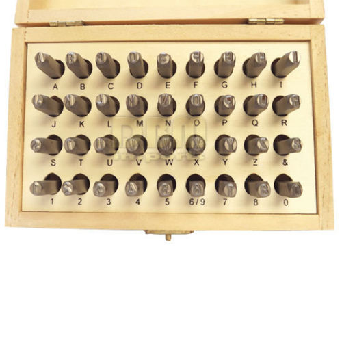

As I recall the correct number/letter stamp size is 6mm. The number stamps can be found on eBay by searching: 36 PC Number Letter Punch 6MM Set Stamp Metal Steel Stamping Kit Wood Tool Case
Not the cheapest punch set, but is looks exactly like the original numbers and letters.
If you decide to make a new one keep the original in your glove box and make a fixture to align the letters / numbers. Also practice on some sheet aluminum you can buy at any hardware store / Lowes / Home Depot before stamping the commission plate.

...As I recall the correct number/letter stamp size is 6mm. The number stamps can be found on eBay... Not the cheapest punch set, but is looks exactly like the original numbers and letters...
6mm sounds far too large compared to what was on mine. The stamping set is nice but again, if you have the number '3' on your plate you'll see that the original '3' had a flat top ( Ʒ - like in a deck of cards) the kit shown appears to have a round-top '3'.
BTW - Wikipedia suggests that the flat-top version was used in applications where alteration was a concern as the common round-top version could be altered to make an '8'.

Could you post a recent pic of the jig you used to stamp the commission plate. Pictures do not open up on this email.
Thanks
Larry S Also do you know what the interior code is for Red assume leather with white piping on the seats?
PhotoBucket will restore that link if I pay them $400 per year.
Meanwhile, we can cheat a bit as Google has cached that pic here:
https://tinyurl.com/ybj5ce4u
As you can see, I used a 2x4 that I had cut one edge very straight. Marks along that edge help align the punch vertically and with the spacing the same as original. Practice on something like a Coke can.
Yes, I will move my photos to another host rather than pay ransom to PhotoBucket - but that will have to wait until I have more time for it.
