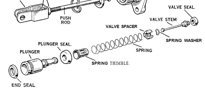

Hi Randall I got the brake master innards apart. The repair kit contains a seal for the front and a larger one for the piston and also a very small ring shaped rubber seal. Do you know where the latter seal would go? There was no old seal like it to replace unless it is to replace the small wavy metal ring that is near the front castellated type piston? Too bad about your 3A...glad to see you have another 3 to put on the road. Karl

Beats me, unless you are talking about the "valve seal" in this diagram. Early Girling cylinders had the O-ring that TOC is talking about, which the diagram calls an "end seal", but it was officially deleted around 1960 (even for pistons that have the groove) and I've never seen it included in a rebuild kit.

Any idea why they deleted the end seal (any TSB's on it)? Sure seems like a good idea having one to keep fluid from immediately draining to your feet when the main seal fails. Having only worked with TR4As and early Spitfires, I've only seen brake and clutch master cylinders without the groove and second seal.
Scott
It's a mystery but it's good to know that Its not needed for the rebuild. The little O ring that I found in the kit was not big enough to be an end seal that was mentioned....it's actually about the size of the spring washer in the picture???
Well, although that diagram makes it look bigger, the end seal is about the same diameter as the wavy washer though of course it is much longer. And it is important, should be included in your kit. If not, I'd say you've got the wrong kit (or it's defective), which could also explain the mystery O-ring.
I've seen a note about deleting the end seal, but can't seem to find it at the moment. But as I recall, it didn't say anything about why, just to leave the groove empty (if present). Gazing into my crystal ball though, I would guess that preventing a leak when the main seal failed was exactly the reason they removed it. The main seal is shaped such that the pressure of the fluid against it helps force the seal against the cylinder, while the O-ring shape would do just the opposite (fluid pressure would tend to force it away from the cylinder). That could potentially cause it to seal when the pressure was low (ie brakes lightly applied for a normal stop) and then not work when the pressure was high (panic stop). A very undesirable attribute, especially with single-circuit brakes. But that's just a WAG.
