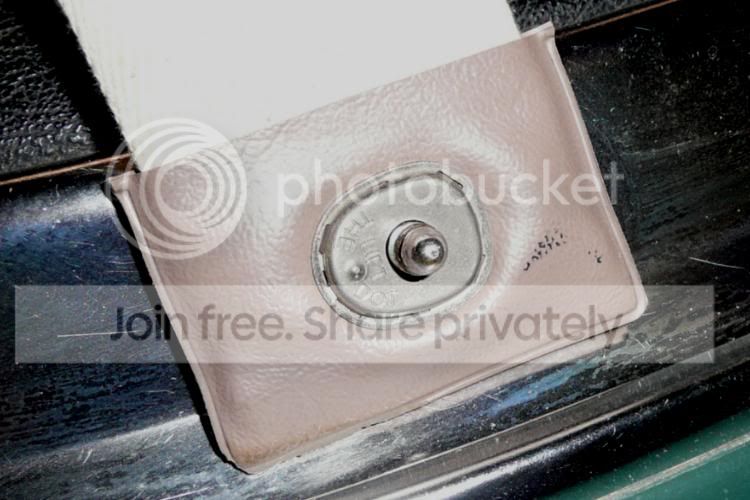

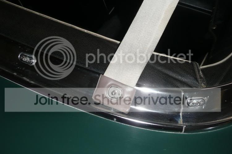

I just replaced the top bow cover on my TR4.After it was complete I noticed 2 of the lift-a-dot studs were longer than the rest.Does anyone know the correct position of the longer studs. Thanks in advance.
those are used to hold the straps for the top frame on the rear trim panel - cant say the exact position, but put your frame up and see where the straps go - that should position them for you.
