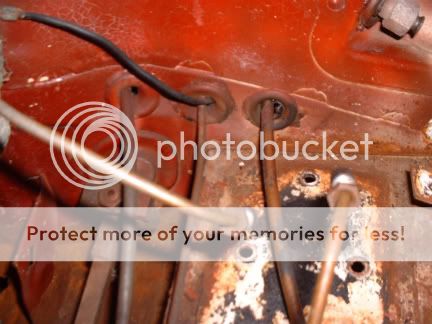

Funny you should ask about the three holes ... I just took a picture of mine (62 TR4) tonight for future reference. Unfortunately, I am in the dis-assembly, not the re-assembly mode.
From the battery side out, my car has the speedo, the oil line, then the tach. My car has had work done on it in the past, so I don't know if its original or not, but my guess is that it is.

From the battery side out the order is: 1) Speedometer cable, 2) Oil pressure line, 3) Tachometer cable.
