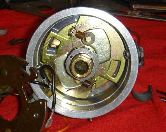

I'm not a big fan of the dual point Mallory distributor. I just took one "on trade" and they are a REAL bugger to get set up correctly. I don't understand the "improvement." The curve is adjusted by bending things! You also lose the vacuum advance unless you spend $500. For that kind of money, buy the 123! Of course a cheap rebuild/recurve is a good option!
