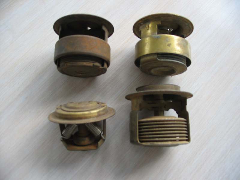

Also, since no one else brought up the old chestnut ... what did you do about blocking the bypass? The original thermostat had a sleeve that moved to mostly block the bypass port when the thermostat opened.
The TR cooling system originally had a thermostat with a skirt that moved along to blank off the adjoining bypass as the engine warmed up. These thermo's were unavailable for many years.
If a non-skirted thermostat has been substituted, the size of thermo that fits the TR3A housing has a much smaller opening than the original skirted item, thus flowing less hot coolant to the radiator. Banked up hot coolant then escapes down the open bypass, and straight back into the engine, adding to overheating.
When a non-skirted thermostat is used, choking the bypass down to a 3/8" hole forces more coolant through the radiator.
Regards,
Viv.
Here they are.
